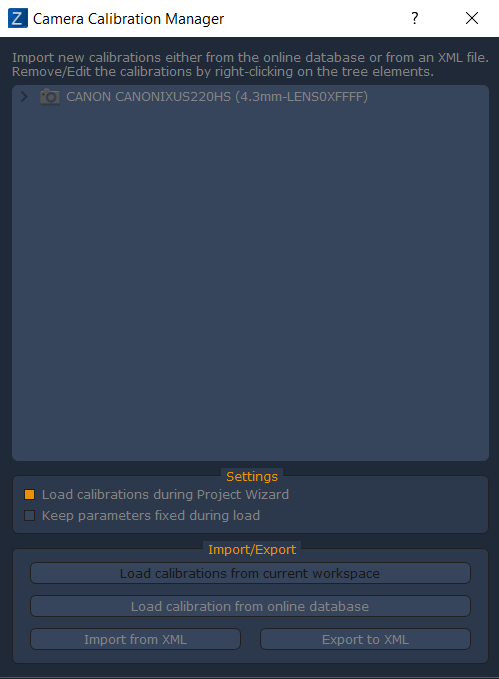

Camera Calibration Manager
The camera calibration manager allows the user to store camera calibrations on the current system. Although 3DF Zephyr is completely autocalibrated, it is useful to start from a calibrated device when possible.
You can import a calibration from the current workspace (if a successful reconstruction has been completed) or you can load it from our online database by simply feeding a JPG (with EXIF data). This service is completely free and anonymous.
You can also import and export camera calibrations from/to XML.
This tool is especially useful for computers working offline, as Zephyr will not be able to check 3Dflow's online database for pre-calibrations.
