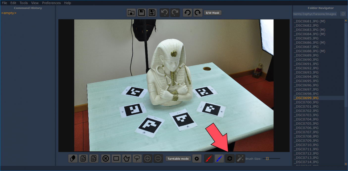

    There are a couple of new buttons now.
    The first one enables/disables automatic recomputation of the mask:
    When enabled, the mask is automatically computed after each stroke as it was before.
    When disabled, the button next to it is enabled, and it allows to update the mask on-demand:
