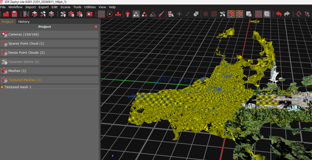

    Anyone knows how to fix this yellow textured mesh? thank you.

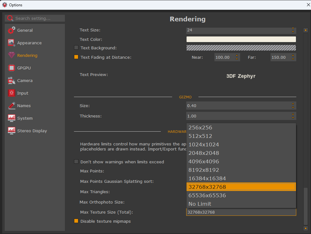

    you've hit your hardware texturesize limit, and thus Zephyr is showing it as a generic texture.
    You can raise it in the options, although note that it might come at a significant performance cost depending on your hardware
