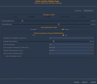

    - Try to use the sharp generation algorithm for mesh generation. In some cases, this works better than the smooth one for bodies (default one for body is the smooth one). Simply switch to advanced mode and select the sharp algorithm:

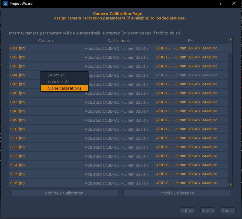

      There are several things you can modify to improve the results. First of all, you need to modify the camera calibrations and let them adjust in an independent way.
      By default Zephyr groups together the parameters coming from the same type camera. Grouping is generally more stable. However, when using a rig of cameras you will get much better results if you let them vary independently, especially in your case as the parameters varies a lot between the cameras because they are different cameras with small sensors. To let them be adjusted independently, simply select all calibrations from the camera calibration page (ctrl+a), right click and select 'clone calibrations':

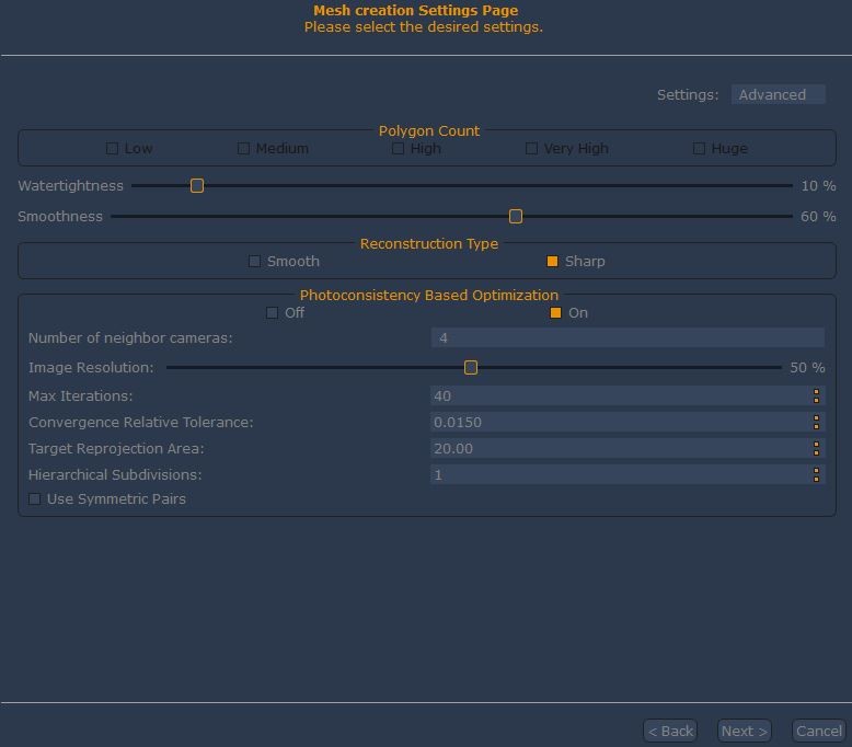

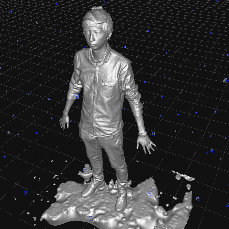

      Just by following this step, you should obtain already a much better results (both with close range and body presets or by decreasing the smoothness from advanced settings):

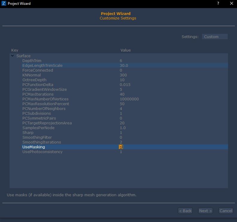

      If you want to improve the results further near the hands, you can mask a few images. You don't to mask all the images, a bunch of 10-20 images will already improve the results greatly. If you have masked some images, starting from the 'close range - high details sharp features' preset during mesh generation you can switch to custom settings and change the 'UseMasking' parameter to 1:

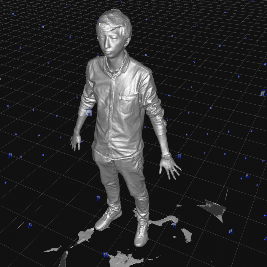

      Final result:
