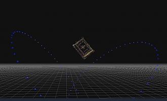

    Hi guys
    I'd like to mask as PNG files but I don't know how to use that.
    I just clipped images and saved as PNG by photoshop.
    Is it possible to use the images as mask files??
    Hi Nakahika,
    you can use png (or jpg) masks file. You should mark the foreground area as white and the background as black. Then simply rename your masks file with "filename"_mask.png or filename"_masked.png (with "filename" the name of the input image), put them in the same folder of the input images, select to use masking during the project wizard and Zephyr should automatically load them. If you are still having issues, please let me know and send me a sample mask file that you are not able to load.

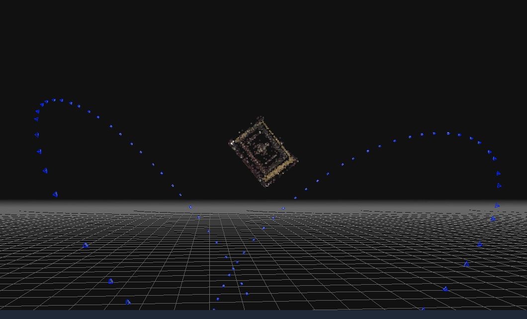

      Hi Roberto
      Thank you for your reply.
      I tried that you mentioned but I couldn't mask using these photo.
      My sample mask file is here. please let me know what should I do.
      Send or share your big files with tenpu. The easy and safe way to send or share to your big files.
        Thanks for sharing the files. I've just test the datasets and it works fine on my side.
        I've made a short video of the procedure:
        Please let me know if you are still having problems

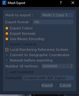

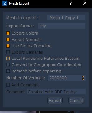

            Hi Nakahika,
            I think your model has been automatically georeferenced by Zephyr (maybe with the GPS information of your camera?) and Blender does not support double precision.
            You can easily fix the problem by making sure that the checkbox 'local rendering reference system' is checked during export.
