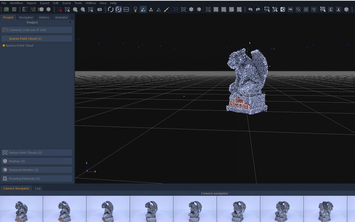

    I'm trying to capture a gargoyle, figured it was a good test, the closest object I have to a rock
    My setup is a foldio360 turntable and tent ala https://3dscanexpert.com/review-fold...hotogrammetry/
    I tried to capture it several times, each time 3DF Zephyr would not put the pictures in a ring around the model. Instead they would be clumped together to one side (see attached)
    Could you take a peek at my photos and see if there's anything I'm doing that's obviously wrong? Or could be done better?
    When I throw the same set of photos at Recap (well, 100 of them, I have a student license) it was able to produce this https://sketchfab.com/models/053d961...0c3db621c521fb
    I hope direct comparisons are not frowned upon, just trying to give as much info as possible so that I can learn what I'm doing wrong!
    Thanks in advance =)

      Hi StartPause,
      I've just try to run your dataset with the latest version of Zephyr 3.503 and with 'close range' - 'default' settings without using any mask. Actually it works fine and all the cameras are oriented correctly. What settings are you using? Are you using masks? From your results it seems like a background problem, but it's quite strange it is working on my machine.
      Can you please share with me the log file of a 'close range' - 'default' computation so I can investigate further. You can send me the log directly at roberto.toldo@3dflow.net if you wish.
      Thanks
