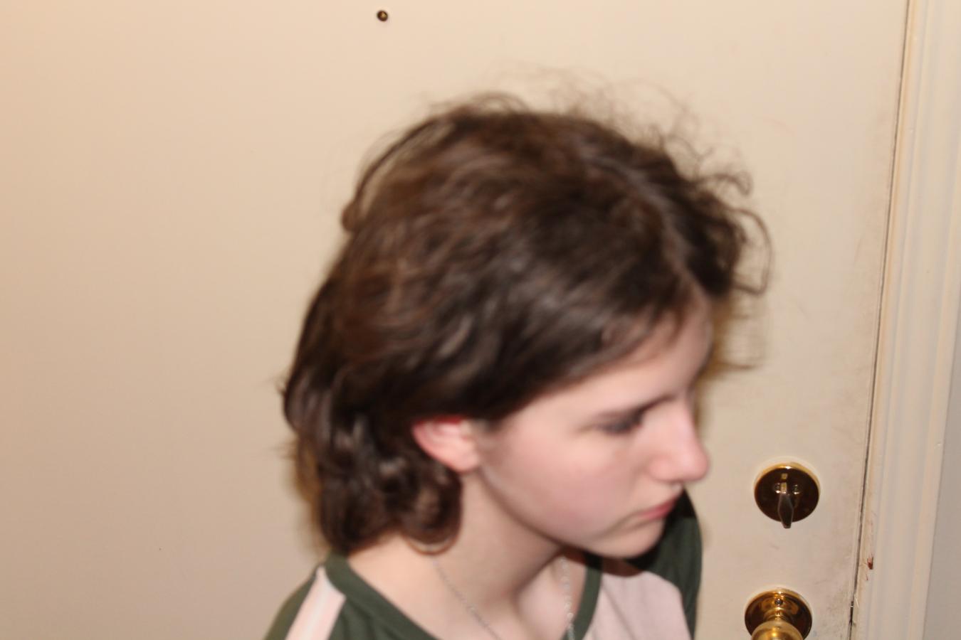

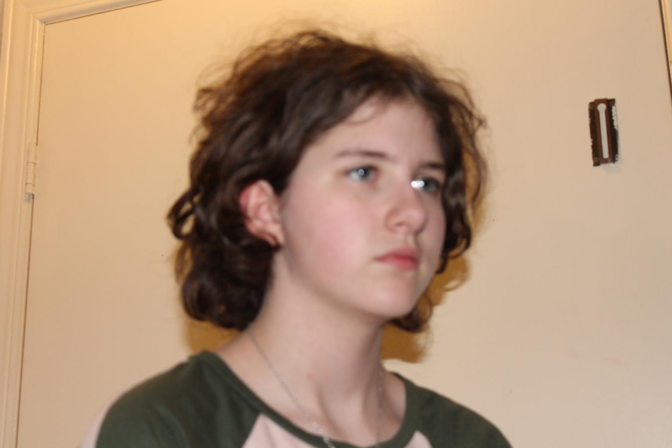

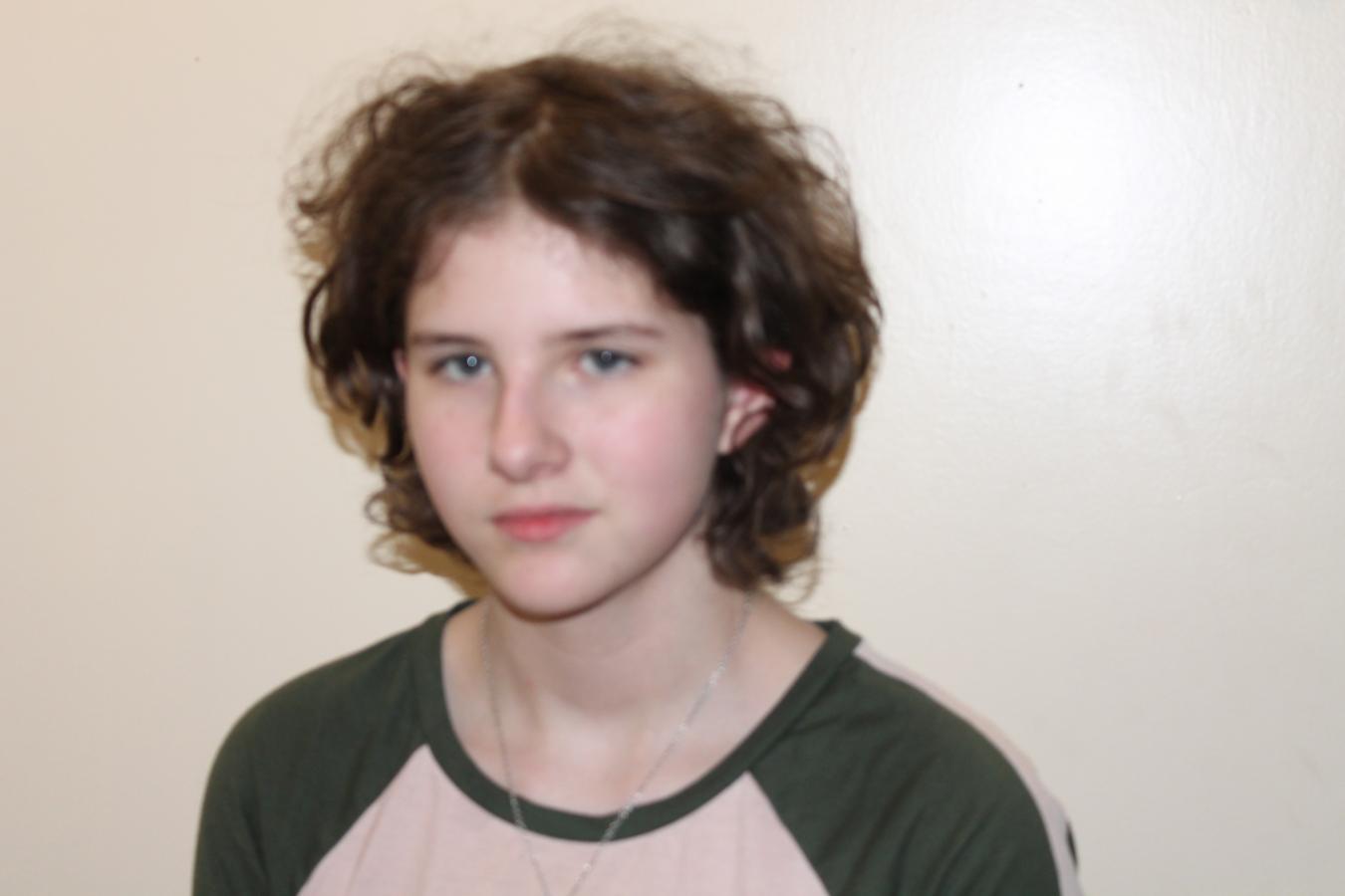

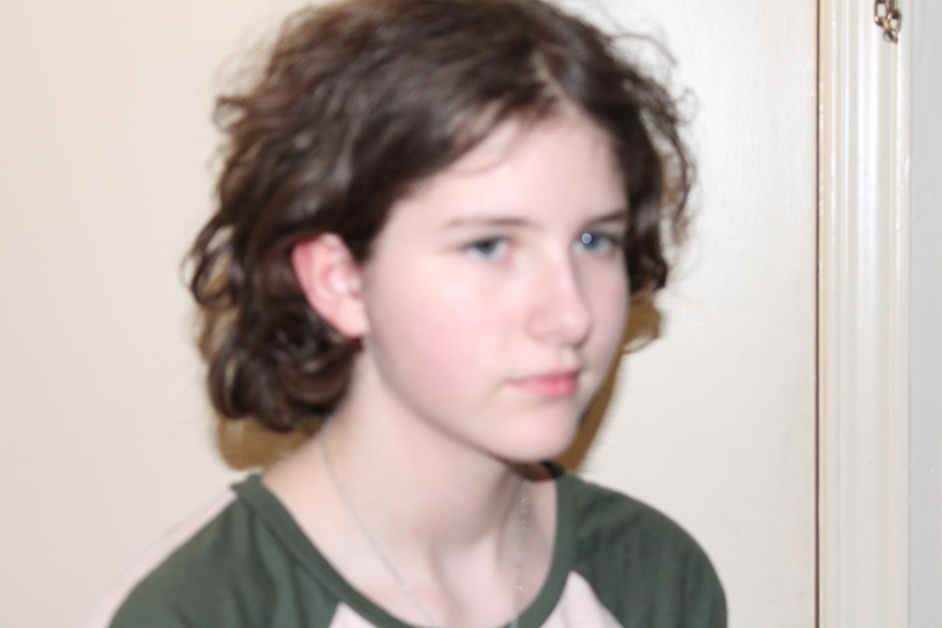

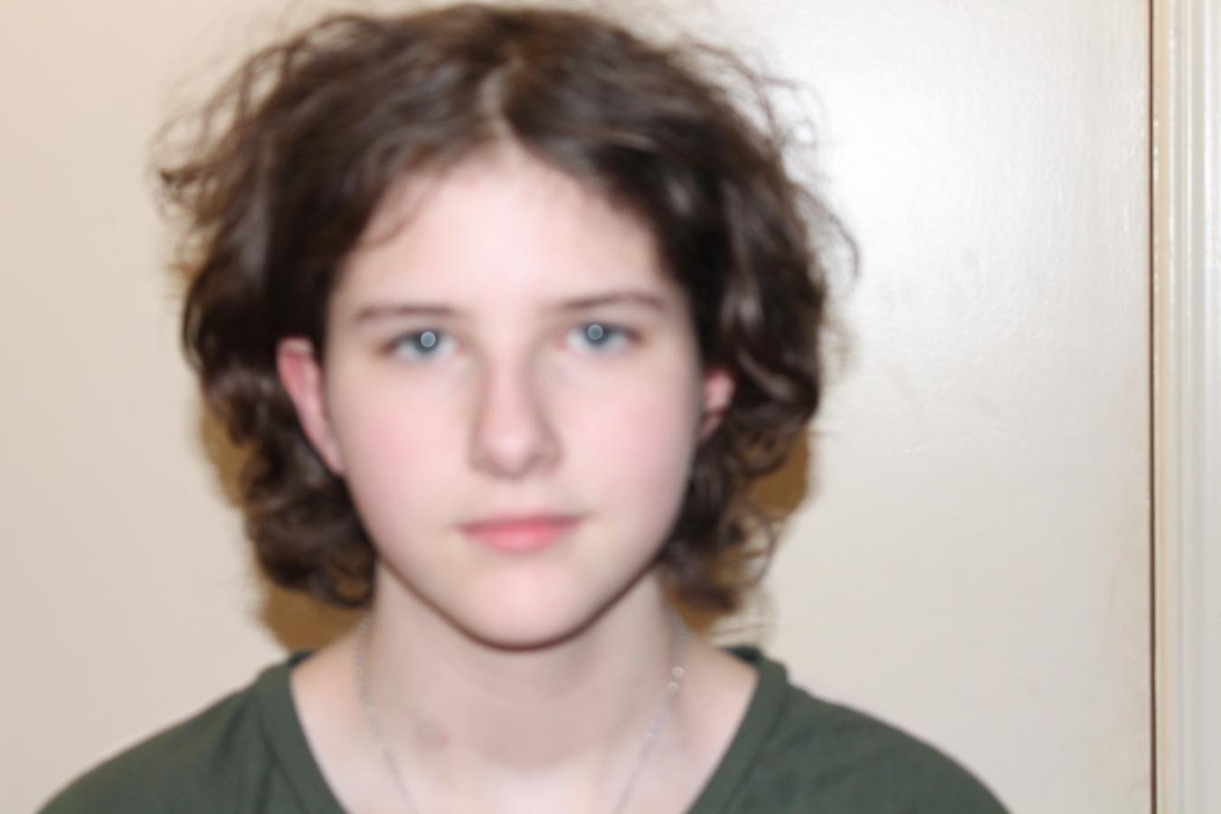

        here's a few of the photos from the data set i was working with. i'll also try taking new photos

          Hey Panda, If possible do it outside when it is cloudy outside. The darkness from the clouds does wonders. Something to look out for as well is the lighting seems difference in the last 2 than the 1st three. If i am not mistaken that can mess with the alignment as well (the 1st three have a whitish background while the last two have an orange-ish look due to the light..

            if you zoom in your photos you'll notice that your friend is out focus, while the door is in focus this is going to be a big problem for zephyr, and most likely will try to reconstruct the door rather than your friend.
            As previously suggested, try going outside for better lighting, but most importantly make sure that the focus is on the subject and not on the background! If your friend tends to move a lot, you may also consider using a video since it takes less time to shoot a video rather than taking pictures, you can find a nice tutorial here https://3dscanexpert.com/free-3d-sca...eo-smartphone/
