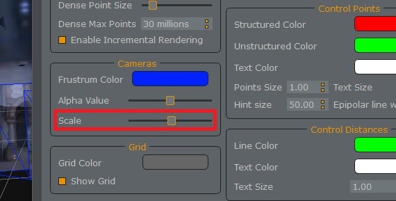

      In relation to the camera element, can you give me a little bit more info on the two pieces that you mentioned (I can't find a camera rescale option in the tools menu, and I can't find any rubberband / lasso selector, and there doesn't seem to be anything obvious in the manual)?
      Thanks again,
      Noel.
        Hi Noel,
        you need to change this slider to resize cameras

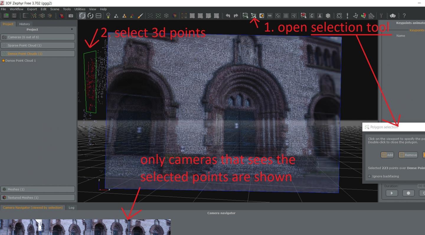

        Note how the camera navigator (bottom) selection shows the cameras seen only by the selected points

            Hi Andrea, Could I ask a follow up on this please? The technique for limiting the photos in the camera navigator no longer seems to work (when an area is selected, all of the cameras continue to show). This did work when you told me about it, but I first noticed that it was not working approximately 1 month ago (and still on v3.7). I upgraded to v4.002, but it still shows all of the photos in the navigator. Has anything changed / should I be using this technique differently now?
            Regards,
            Noel.
              Hi LiNo,
              I made a quick test, and the selection of cameras seems to be working fine. What object are you selecting? Can you please try to pick only a tiny portion (just a few points) of the sparse point cloud or the dense point cloud or the mesh? Please note that the the subselection of cameras doesn't work on textured mesh objects as there's not visibility information saved in the textured mesh.
              • LiNo
                • 44
                Thank you Roberto. That was the problem (I had been trying to use it on the textured mesh). Thanks for your help.
