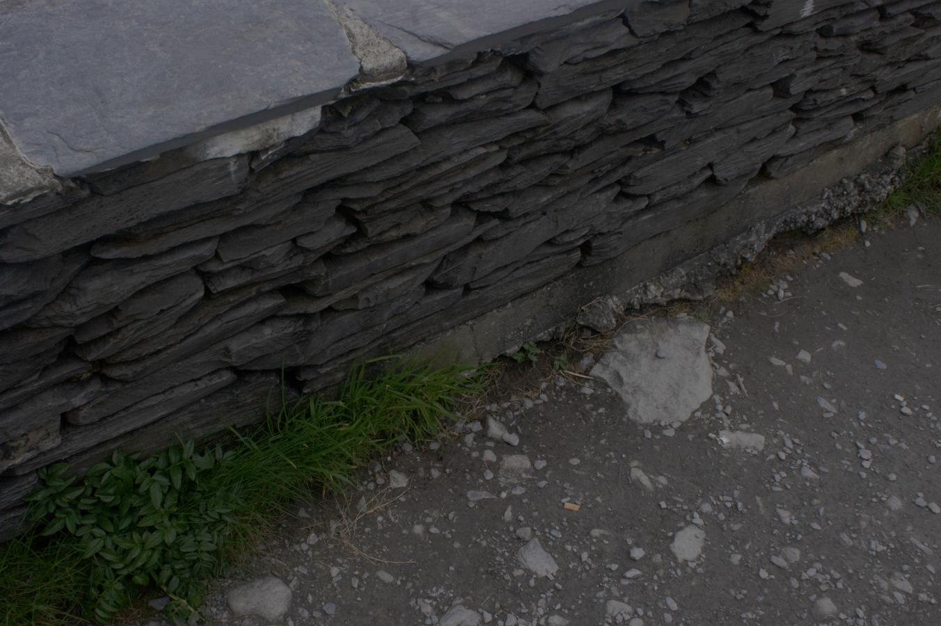

          Thanks Andrea. That all makes sense ...except the level of noise - good camera, low ISO, fast shutter speed - that should take care of that right? I have attached one of the photos that was rejected (for easy reference, there is an associated mask aswell but I could not load this, however it is on this link https://1drv.ms/u/s!AgdskftNUq2xi5c-nUfRKTAdoJEM4g).

                Hi Noel,
                I had the chance to take a better look at your dataset.
                The problems is ultimately with the quality of your images. Not only they are very dark, but they are also very noisy. This noise creates false matches between the images, with ultimately result in the famous split you mentioned in the other thread and also fails the add of new images on an existing workspace.
                Always zoom in to understand if your images are good enough, as looking them resized for the screen doesn't really shows you the defects in your images
