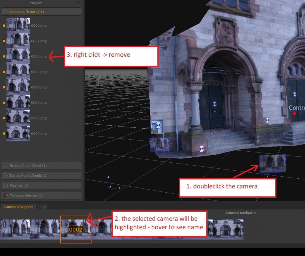

      You can doubleclick any camera in the workspace to directly zoom to that camera point of view. By doing so, the camera will be automatically highlighted in the bottom view. You can hover if you need to see the name. Then, simply remove the desired camera from the camera panel list by right clicking and then selecting "remove". Please note that you'll need to re-compute any object you may have already computed after the SfM phase (so all dense clouds, mesh, and textured mesh). You won't lose existing objects, but of course, they will still be the same, with information of the wrong camera.
