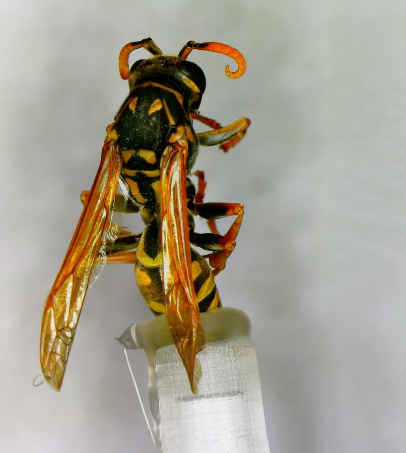

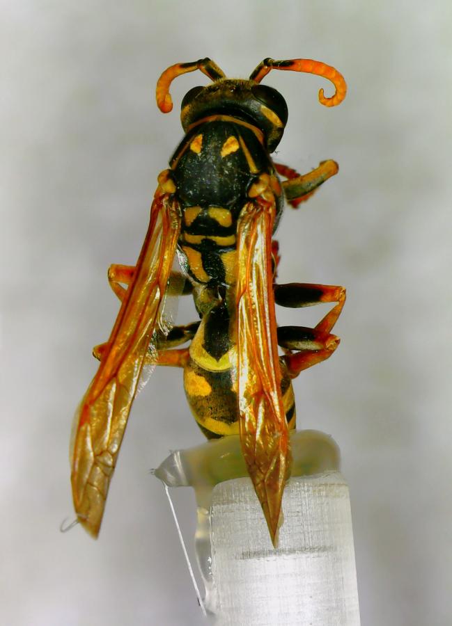

      I've attached a couple of pictures illustrating a common problem. Sometimes, the images generated are offset significantly with white space to one side. If the images are masked, would this confuse the software (should I be making an effort that the objects are all centered in the image)?
      I'll continue to experiment. I really want this wasp scan to work: https://imgur.com/a/jv1AUFL
      So far I have gotten a max of 15 out of 40 cameras oriented, though.
      Thanks again for the help and encouragement!
        Hi Wayne,
        with more Orbits, Roberto means that after you have done a full orbit, you should change the camera position and rotation. You can see an example of this technique from our tutorial #1, where there are three orbits of the cherub statue at three different heights.
        For example from your gif, i would then take another orbit with the head as "center" of the image, and another one with the abdomen as a center of the image, so to speak.
        The object does not have to be at the center of the image. However, i see that the two images have two different resolutions, so zephyr will treat them as two different physical cameras. Are you cropping the images or is the microscope outputting those images as we see them? Even if those are virtual cameras, do not crop the images if possible
