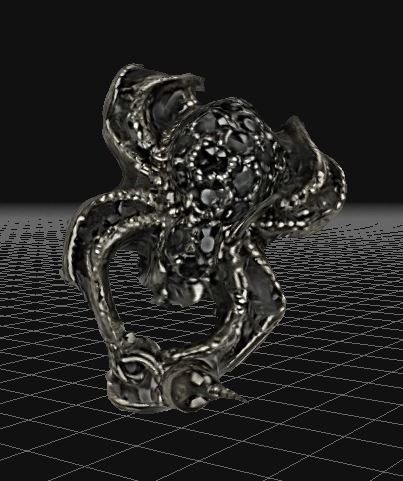

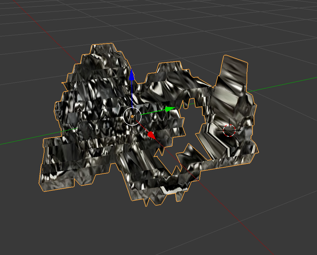

    I'm seeing an issue where I export an OBJ/MTL textured mesh from 3DF Zephyr Free which looks like photo (3df.JPG) attached. And opening it up in Blender looks like photo (Blender.png) attached. It looks like it's missing sub-meshes or something. Has anyone run into this issue and/or know what how to fix it or is it a 3DF Zephyr bug?

    When you export your mesh from 3DF Zephyr, tick 'Local Rendering Reference System' - This should solve your problem!

      Quote from Roberto: 'I think your model has been automatically georeferenced by Zephyr (maybe with the GPS information of your camera?) and Blender does not support double precision.'
      - I had this same problem about a year ago and it drove me crazy trying to solve myself! - Let us know if this fixed your issue

        Awesome that fixed it. It's not available in the "Generate and export enhanced mesh" workflow. Only the "Export textured mesh" menu item.
