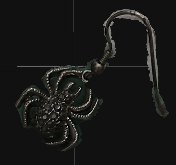

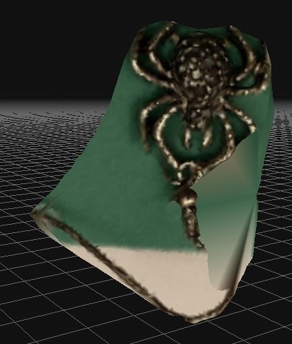

    -When I clean up points in the "Dense Point Cloud" and generate a mesh it causes some vertices to be interpolated when there are holes in the mesh. This creates unwanted artifacts on the subject. (See interpolated.png)
    -When I use "Manual Selection" on "Meshes" it causes jagged lines on the border of the 3D subject and background that I want removed. (See jagged.png)

    Hi Tomkit - I think the best thing to do here would be to shoot with a white background, and use masks to strip away the background using 3DF Masquerade. I wrote a little tutorial on this:
    https://www.3dflow.net/technology/do...for-turntable/ - Have a read over it and try and apply some of these principles - It's always easier to work with clean data, rather than try and cleanup in post.
    Capturing as many sides of the object as possible will help eliminate extrapolated polygons because 3DF Zephyr will have more data to work from! Ideally you'd capture the whole thing but that can be a bit tricky. Worth it though!
