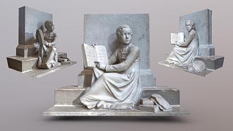

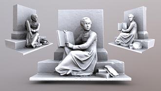

                For ISO it really depends on your camera sensor and what the scan is for. I can push my Canon 6D Mk2 to 3200 iso and still get something like this: https://skfb.ly/6D79x

                The lower the ISO the better, but sometimes you simply don't have the time or the option to use a tripod!
