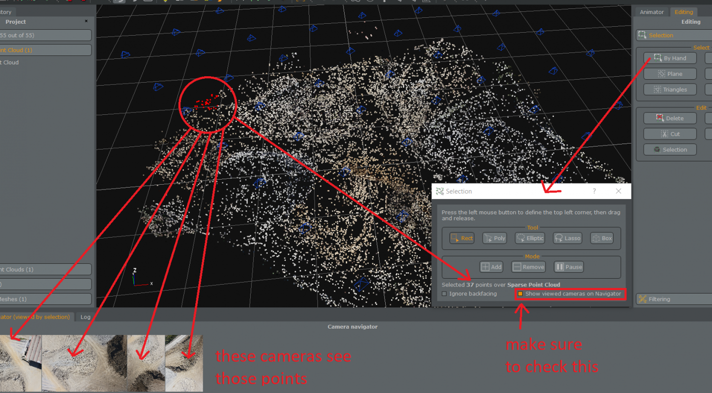

    3) Suppose I have a project with 200 photos again, which all are 'aligned' according to Zephyr, but I get to the final textured mesh and some reconstructed text on my subject is blurred or there are two pieces of the "same" text slightly apart (so obviously one or a few of the cameras are not well enough aligned), what is the easiest way to identify which photos are causing the issue? I can just remove them one by one but this is obviously time consuming - Is there a way to click on sections of the dense point cloud and see what images that point comes from?

    3. if you select points with the selection tools, you'll see that automatically in the bottom window (the camera navigator, switch from the "log" tab to "camera navigator" will show only the cameras that see those points. From there it's easier to understand which cameras are problematic. Please also note you can simply exclude cameras from texturing rather than removing them completely from your project.

        Regarding point 3) - please could you elaborate with more detailed steps - I wasn't able to get it working? i.e. First of all ahould i be doing it from the sparse or dense point cloud?
          Hi beardless,
          it's for both sparse clouds and dense clouds. Make sure to tick "show viewed cameras on navigator" though (my bad for not mentioning this!)

            Hi Andrea - Thanks - got that working. Once I have got it into that subset mode - how to get get it back to normal? (i.e. un-select all the points so all cameras show again)
            • beardless2
              • Oct 2018
              • 24
              ah got it - double click!
