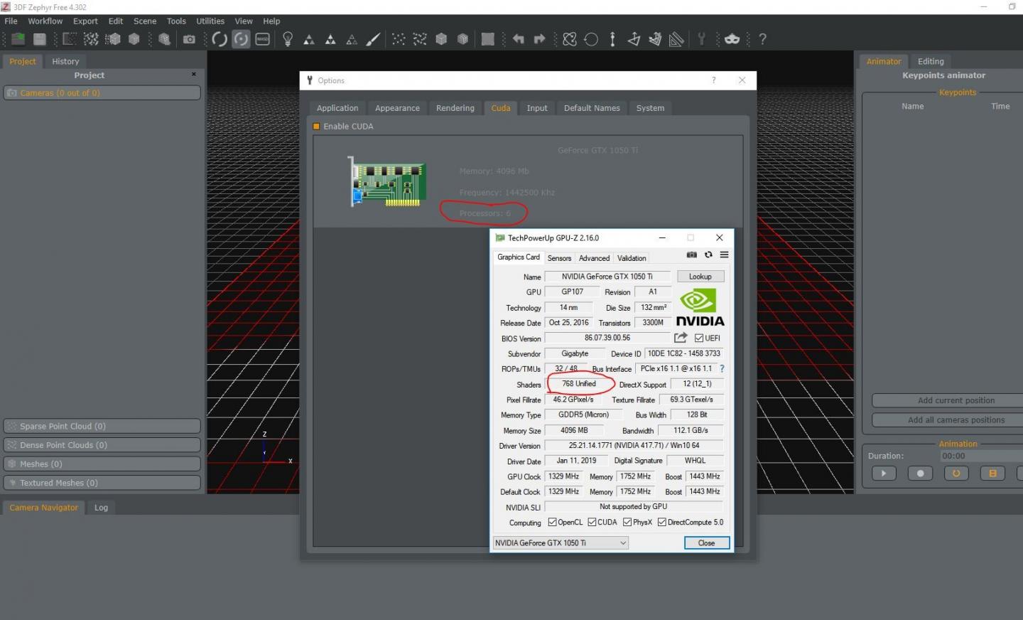

    Hello everyone, i have this small issue.... I have a cuda Geforce GTX 1050ti card and cuda drivers installed... But zephyr sees only 6 processors from 768...? Why? I run CPU Z and it shows normally CUDA enabled and 768 processors. Any ideas if this is normal?

    I don't think that there is anything wrong - My cards show similar numbers (980ti = 22 & 1070ti = 19)
    I am curious as to what these numbers are referring too though, they definitely don't seem to be the number of CUDA cores.
      There's nothing wrong. In that dialog, we report the number of streaming processors for the GPU. Each processor has Cuda cores depending from the architecture (in your case it's 128). Hence 128 * 6 processors = 768 Cuda cores.
