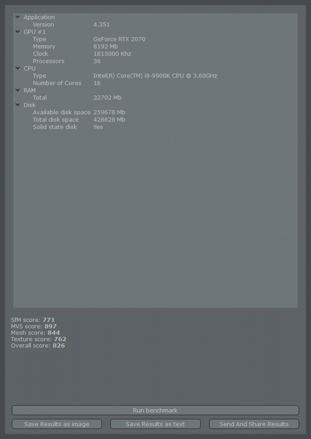

              These results are very surprising for me. I reran the 3DF Zephyr benchmark with 4 CPU cores enabled and again with 8 CPU cores enabled. In case you are interested here are the results.
              <edit>I'm going to have to retest with the SLI and EMG GTX 970's</edit>
              Nobody will ever suspect that it was me all along....
