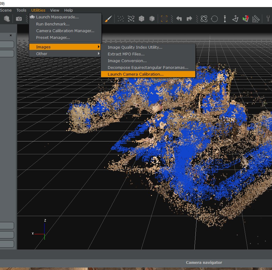

    You can calibrate your own cameras using 3DF Zephyrs camera calibrator! Just follow the onscreen instructions
      Hi Cheesenacho,
      to add on what Cam just said, you can also export a calibration from a successful reconstruction!

        Thank you...I am having trouble getting a good output. It looks like I may need to try the calibration with the drone camera.
          • 704
          Yeah calibration can help a lot! I've only really done it with one lens, an 8mm fisheye, but it seriously improved the reconstruction!
