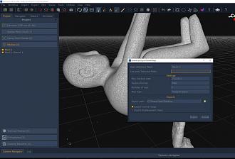

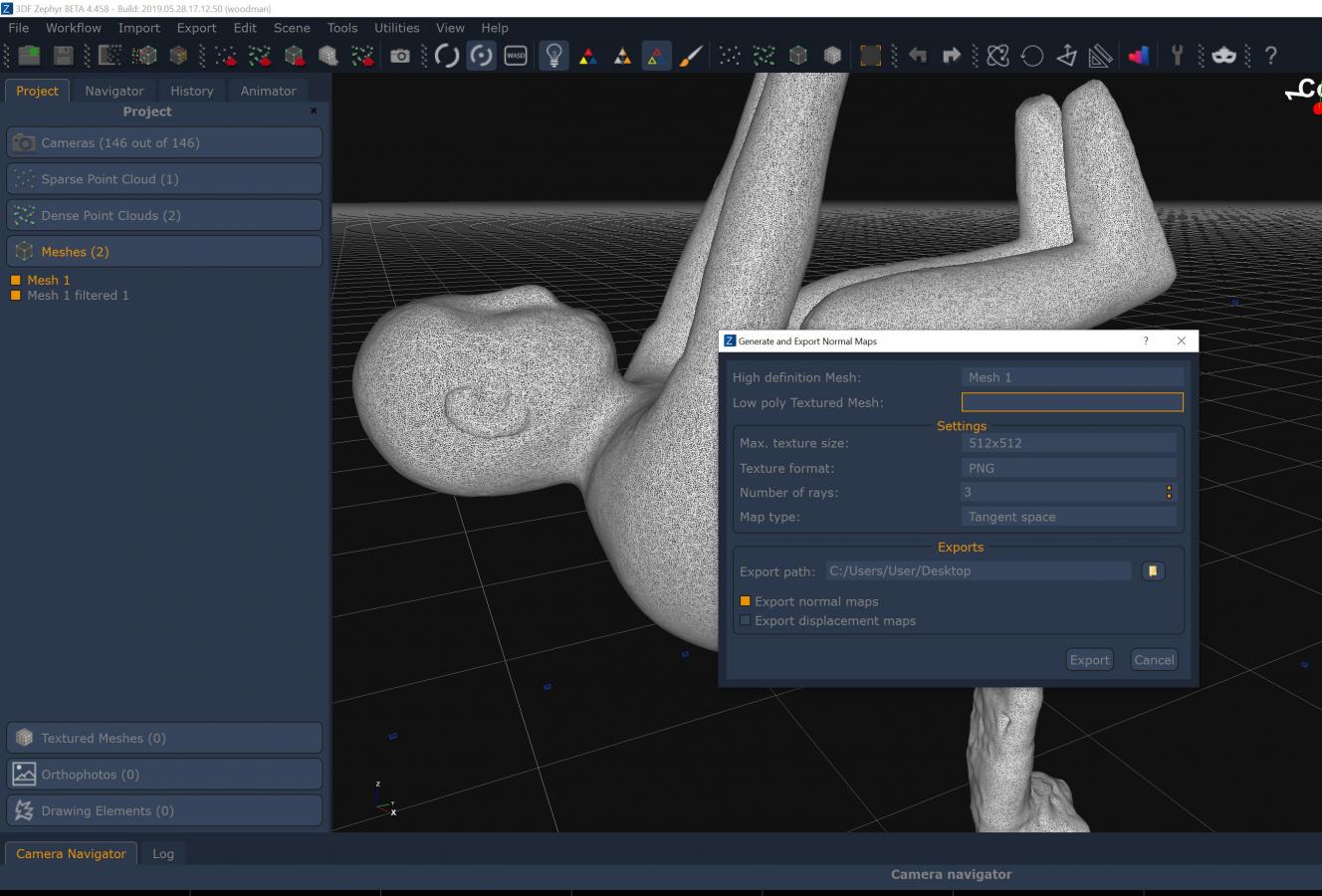

    Nice! I'm having an issue with the generation of normal maps - I don't seem to be able to select a lowpoly model! (Second text field isn't giving me any options - I have two meshes in my project, one high and one low.

      Hi Cam! You need a lowpoly textured mesh
                    Makes sense! Totally forgot UVs weren't generated yet. Would be good to have a warning that it needs textured mesh and/or greyed out as an option until textured mesh created

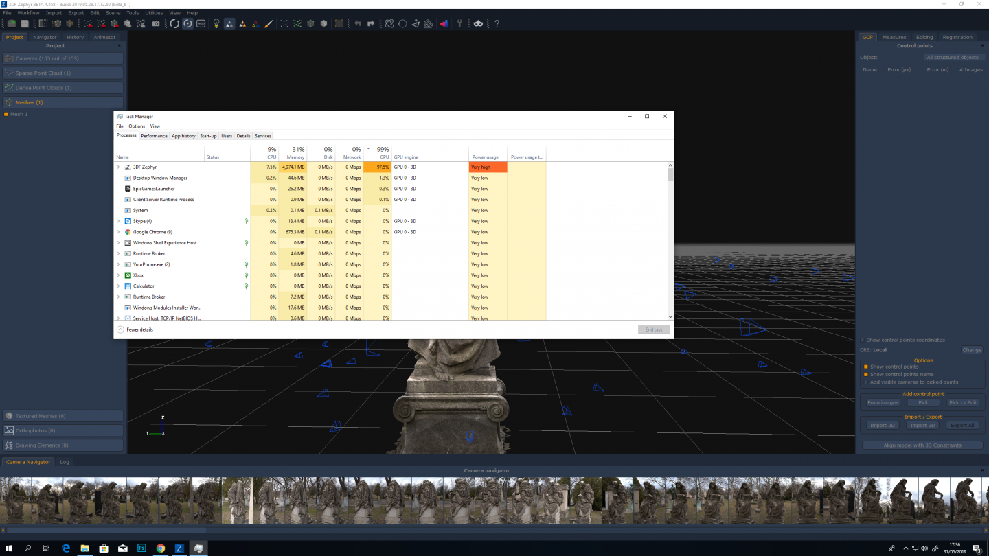

                          I would have a question: Do Clementine works for the beta testers as a cloud rendering server? I generated a dense cloud+mesh to testing out the normal and displacement map content, the work was done, no other workflows were running inside Zephyr, I made a break and when I arrived back my pc was super hot, my GPU was on 100% (RTX 2070) used by Zephyr, but there were no actual workflows on my side. It was a bug? Or we, beta users are building up a kind of a cloud render farm for Zephyr till we are testing to let it test, calculate, solve this and that and with that helping the development? I attach the image how it happened:

                            edit due to my post above: I made a bunch of tests tonight and had to realize, that simply the highpoly mesh visibility rendered out on my viewport the reason of my constant 100% gpu load, no matter if it's static or I'm moving the camera around. If I change the viewport render to - "show point cloud only" my GPU load immediatelly falls back to 24% (RTX 2070 Gainward phinix on Nvidia creator ready driver) Right now I'm waiting for a cleaned dense pointcoud reconstruction, it was not an easy ride to import it back, the original exported mesh had a lot of shells had to fix it in netfabb and than do the cleanup in zbrush. I tried to close the mesh inside Zephyr by using watertightness (in prior version it went well) but now it loaded up all my 32 gig ram to 100% + my ryzen 2700x to 100% as well (all cores were on constant 100%) and it stucked in the solving stage for 30 minutes. I could not even abort the process, had to shoot down Zephyr. I had a few crashes, I made a bunch of screenshoots about "strange" scenarios. Can you please send me a mail where I could/should upload my beta reports?
