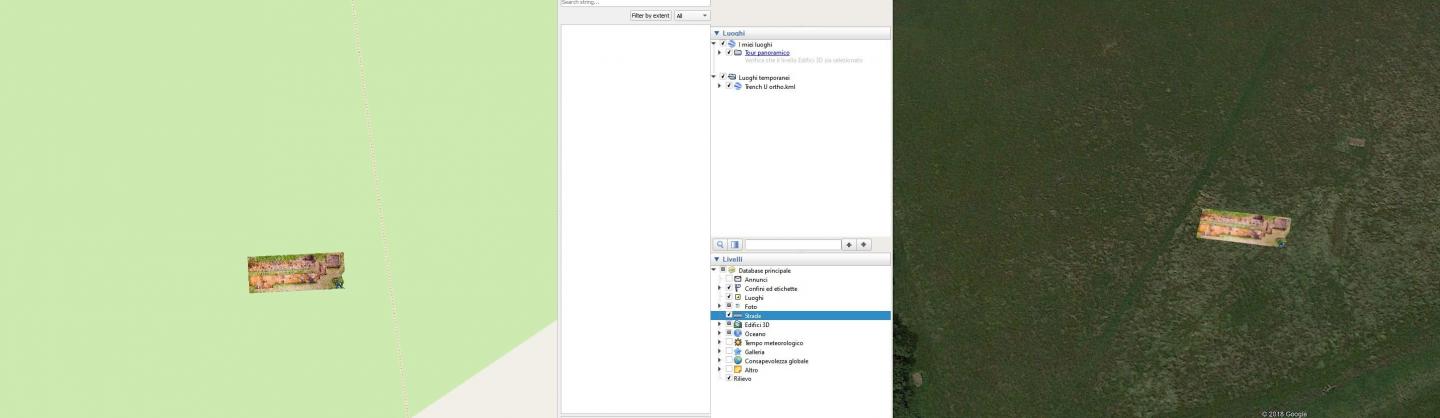

        I've made a test with the current beta, using the CRS provided from Andrea (which is now already included by default). The orthophoto exported in QGis seems fine, and it's in the same location of the KML file. I've loaded your orthophoto, and it also looks fine. The KML file has lat-long coordinates, so there shouldn't be any coordinate system problems (left QGis, right google earth):
        Maybe it's an importing issue in QGis? I drag-and-dropped the file without changing anything.
