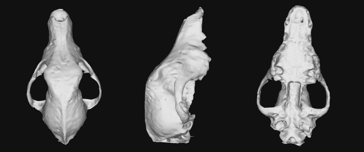

            Ok so the new settings work fine and got a successful dense cloud - Doing the same with the mesh now and will post a screen shot. - Another thing to note with this dataset is that you only have one elevation captured - By adding an high angle and low angle elevation (bringing the total number of photos in the dataset to 216) you'll have more coverage of the subject and therefore get better results
            Mesh was built with 100% resolution as well (normally 100% on any setting is not advised because of processing times vs diminishing returns but this was a unique case) and all other settings default - If you have questions let me know and I'll do my best to answer them!

                    3DEnthusiast - Great to hear you're learning about all the fun elements which come together to make a photo. Andrea is going to be able to give some more specific feedback once he as seen the logs, there might be a rare bug that is making things extra hard. As for camera settings and framing, based on the information you have provided I'd be inclined to use settings as follows:
                    600mm from camera sensor to subject
                    50mm focal length
                    f/11
                    Shutterspeed - Whatever you need as long as you're using a tripod (also a shutter release cable or 2sec timer will reduce the chance of any motion blur cause by your hands)
                    To be fair though, without a more hands-on approach I am just making guesses based on my own experience and this may or may not be applicable - One thing to add is that even if the whole subject is not perfectly in focus, it's not a deal-breaker as long as the out of focus surface is in focus in other shots.
                    One other thing I'd like to clarify: When you say garbled, can you please post a screen shot of the results your getting? There are some other things which might be causing problems but it's very hard to tell without the visuals
