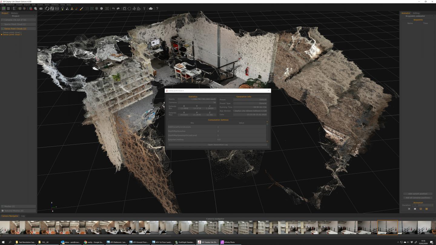

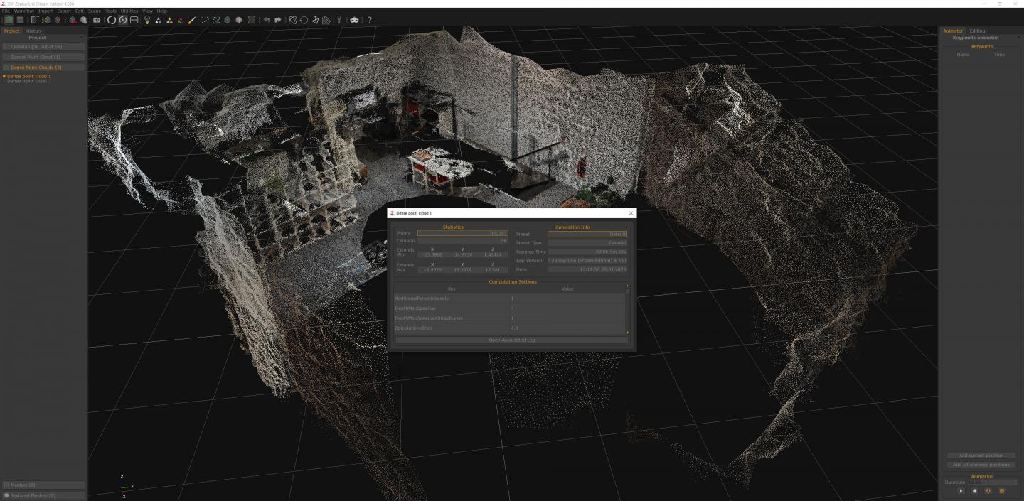

      Please could you take a quick look at the attached screen shots?
      The wizard version determined ~360K Points & the manual version was ~1.9M Points (381K seed) from the same data set.
      Can you clarify how i should interpret this? i.e. has the manual process just created a denser DPC, is the wizard version more efficient/optimal etc?

        Hi Sam,
        as the settings are slightly different, indeed you can get different results. The difference seems substantial, maybe you switched from default to high details (preset), then switched to advanaced (keep the values as close as possible to high details rather than default) ?
        Anyways, if you want to share the zep file I can double check.
