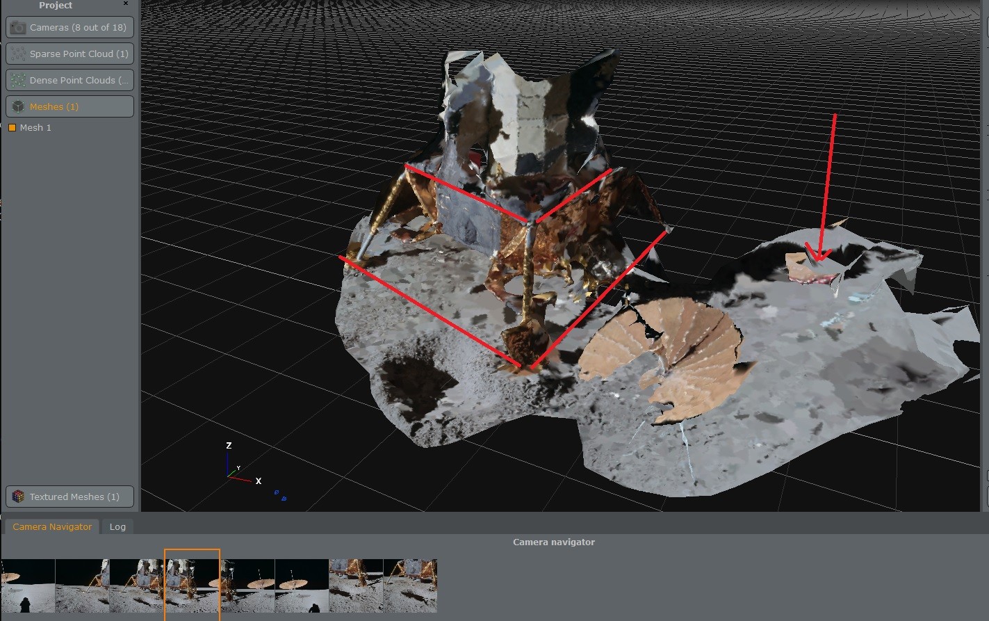

    Hi, I am a complete nubi in photogrammetry. Simply out of curiosity I thought I'd try to see what could be done with the photos from the Apollo 14 landing images. I was particularly interested to see if the various packages could extract distances as the dimensions of the LEM are known.
    The astronauts used a Hasselblad 500 El. On the lunar surface the photos of the LEM and surrounding adjacent were taken with a Zeiss Biogon 60 mm lense whose focal length is given as being 61.1 mm. The Field of View is said to be 49.2 deg side, 66 deg. diag. The film negative of the images was on 53 mm X 53 mm negative. The only info I knew how to use was the focal length which I put into the image EXIF.
    Here is where I found the images, https://www.hq.nasa.gov/alsj/a14/images14.html#Mag65
    The LEM was photoed from two different sides. The first such sequesnce of images where the LEM is seen starts with - AS14-66-9252.jpg. The second, astronaut is much further away, starts with AS14-66-9274.jpg.
    What I wanted to share here is my observation about 3DF Zephyr. IT IS VERY GOOD !!!!!
    The photos available are very limited. But I nubi managed to get a fairly good 3-D model only with Zephyr. I tried this with Meshroom, Agisoft Metashape and Reality Capture with dismal results, basically no results. I realize that I was using the free incomplete versions without control/marker point usage. Additionally being a nubi without deep knowledge I was probably not getting optimal results. But using 3DF Zephyr straight out of the box with near auto guiding and little sophistication by the user, gave me results that simply are impressive. Zephyr was able to resolve the angular shape of the LEM from just a few photos taken by the astronaut JUST ROTATING his body, hence he was not moving around the craft. Whatever is the algorithm picking tie points/markers, well it must be super good.
    If anyone has the energy to try out this project I would just love to see what a really good user could do with 3DF Zephyr and these limited number of images.
    Again, Great Software !!!!
    Ciau

      Hi cam3d
      Thank you for the reply. It's no hyperbole from my side to say that your software kicks *ss.
      I do have one question that I am not all clear about despite digger around. I understand that masking the images helps during Image Alignment so as to eliminate background information from the images that may confuse the algo as to ?Caption
      what is the object of interest to focus on. What I am not clear on is whether or not it is possible to tell the software "This point and this point and this point on these images are the same points. Focus on them !!!"
      I as this because several images I used to my human eye said, "There is no way to reject this image", yet the software did. How can one diagnose to find out what caused the problem and is there a way to direct the software to specific points in the pictures ?
      Cheers

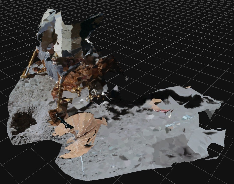

      PS: Just for illustration I include some screen captures. Please don't be horrified as I was ONLY using 8 photos with minimal lateral movement. The four red lines in the 3D model nearly perfectly are as in reality. What was most surprising for me was the correct placement of the flag. Flag which appears as nearly nothing yet was located in the right place with +- a meter or two from the correct position. That blew me away, as NONE of the other software could handle this small data set. I suspect they are geared for high density imaging.
