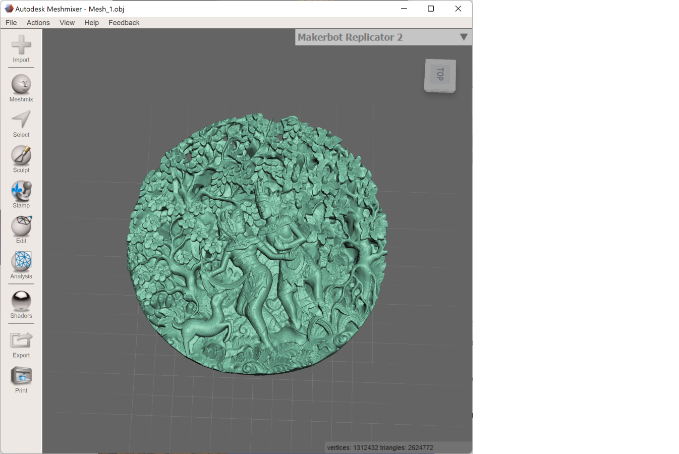

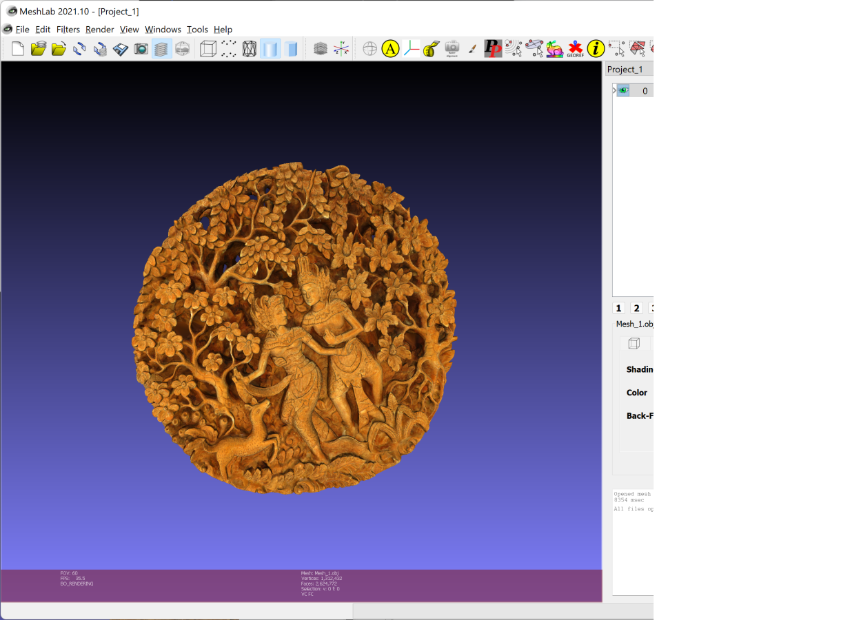

                    well I ve come to the conclusion that the mesh as opposed to the textured mesh is much better but it also seems to depend on which viewer software you use.
                    meshlab provides very good surface reproduction with colour while meshmixer seems to ignore it and chooses a default colour
                    the same Click image for larger version
ID:	7873Click image for larger version
ID:	7874 object file is used in both caes

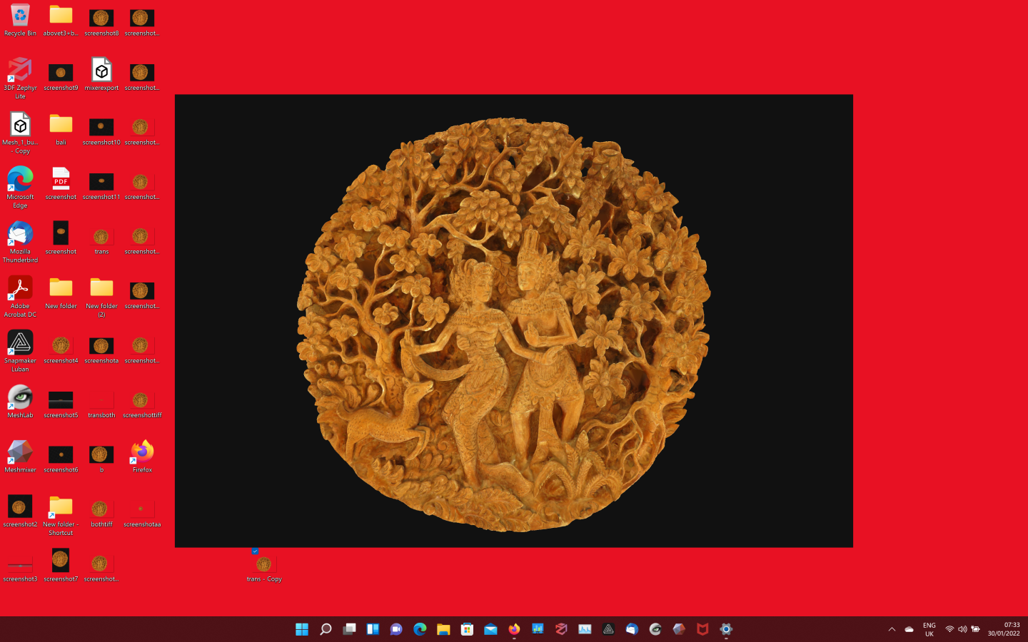

                      PS Does the screenshot background transparency option work ? Lite 6.010
                      must be doing something stupid as I keep getting a black background Windows 11 Pro
                      • roger johnson
                        • Nov 2020
                        • 61
                        in other words the viewport colour set in options>>rendering is not being set to transparent as I expect.
                        the only reference to transparency I can find is under drawing elements
                          Hi roger johnson
                          From the screenshot with the desktop background I can see that you have multiple thumbnails of screenshots from 3DF Zephyr, and they look like they have transparency as they are showing the red background of the desktop around the subject itself? I tried the screenshot functionality myself and transparency appears to work fine on my end (Export>TakeScreenShot>TransparentBackgroundON) so perhaps it's just that the program you are using to view the image files has a dark background and this is layered under the image itself?
                          I've attached a screenshot with transparency to this message. Download it and see if it works on your computer. If it doesn't work on your computer, then your issue is with the program which is viewing the image file and not the file itself.

                            Regarding textures or untextured meshes:
                            Generally speaking a 3D mesh can be in three main states:
                            - Monochrome (no vertex colours or uv textures, just a solid colour which is decided by the program used to view it)
                            - Vertex colours (colour information is held in the vertices which may or may not be rendered depending on the program used to view it)
                            - UV Textured (colour information is mapped to the polygonal surface as a seperate file, typically a JPEG or PNG)
                            When you generate a mesh file in Zephyr the default action is for it to also generate vertex colour information. This can be switched off under the advanced settings in the mesh creation wizard. You can also choose not to export this information when you export a mesh (Export>ExportMesh>ExportColoursOFF)
                            When you generate a textured mesh in Zephyr you are also generating a separate image file which is mapped to the polygonal surface and the vertex colours are no longer present.
                            Different programs handle files in different ways, and we provide many options to customize your output for any given third party software. Meshlab and Meshmixer render the same input in different ways - Meshmixer is heavily model clean for print and doesn't handle UV textures well. Meshlab is more robust in this regard and has more options for viewing models of different compositions.
