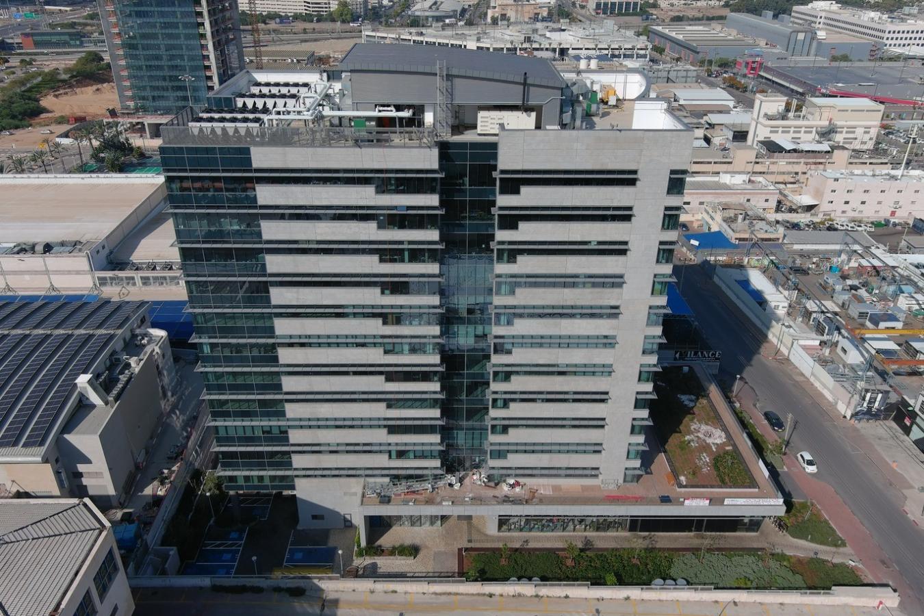

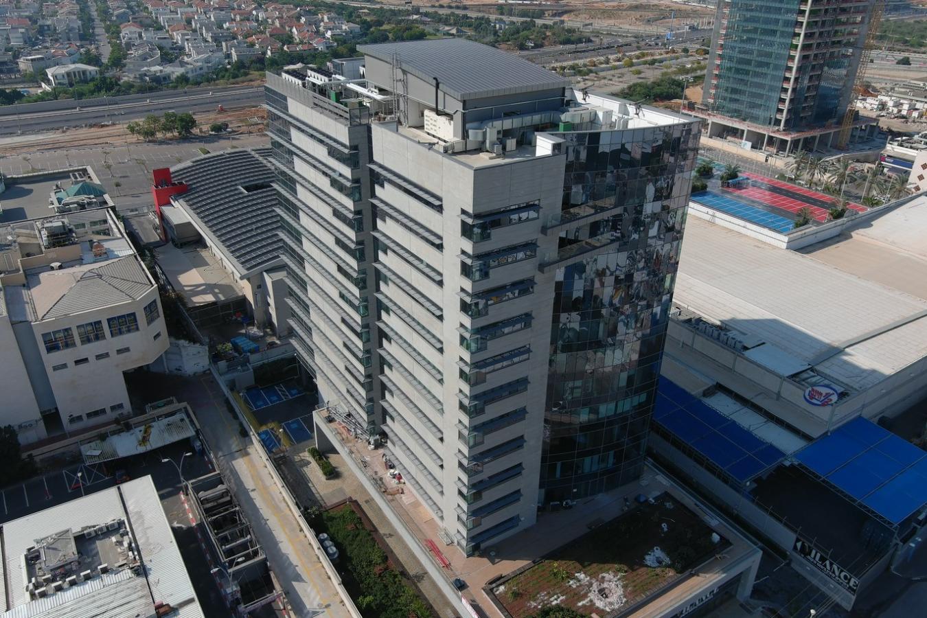

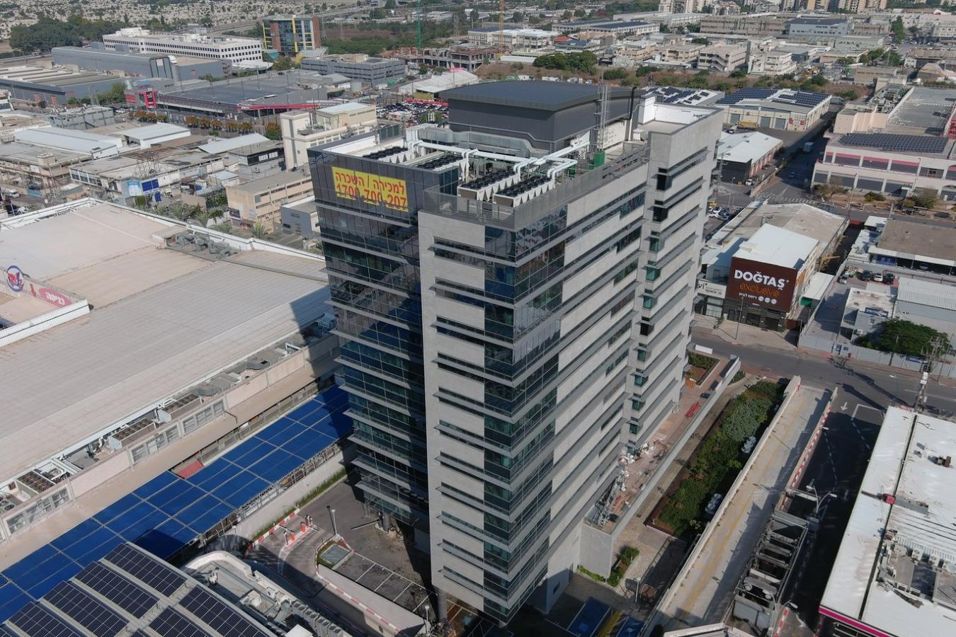

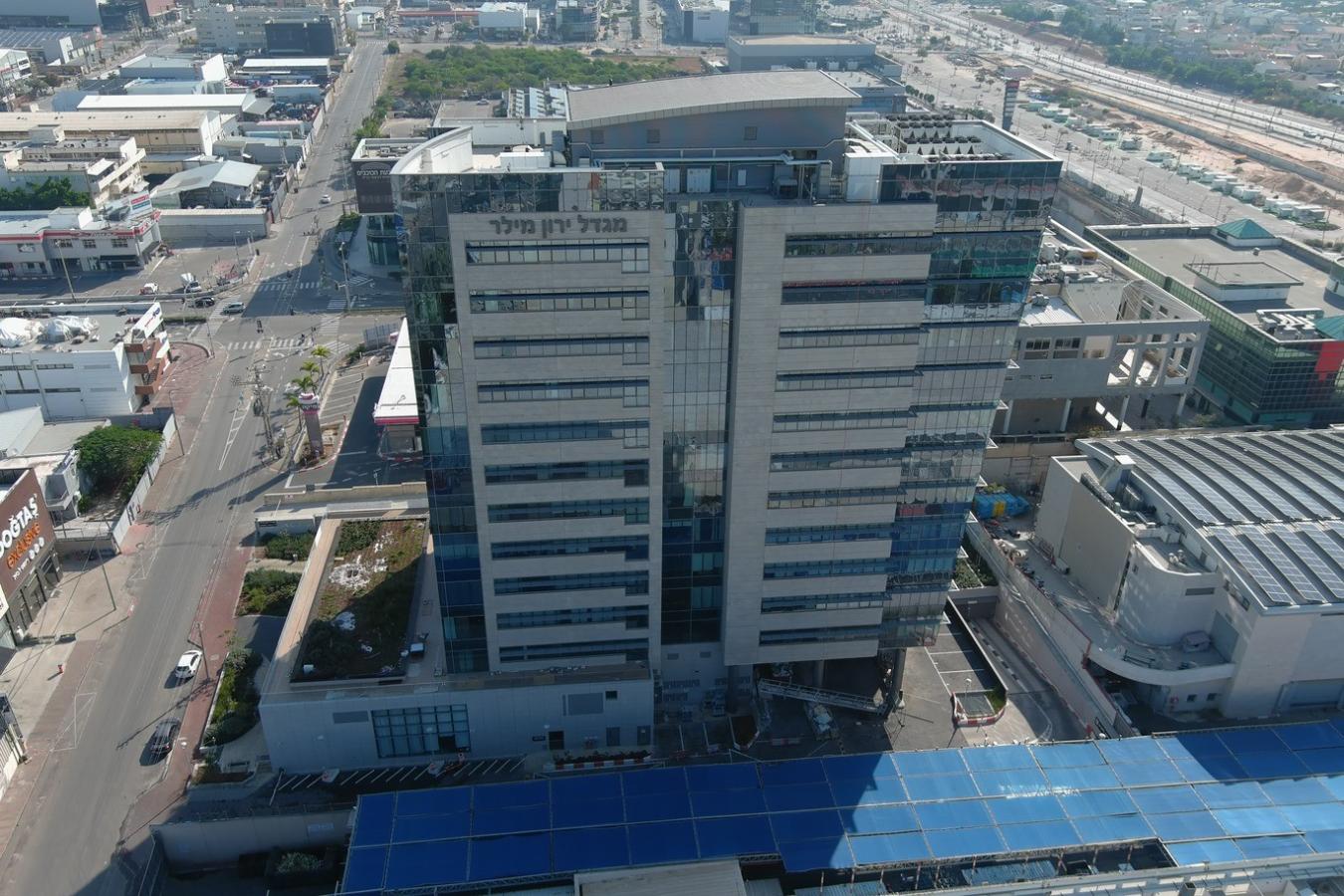

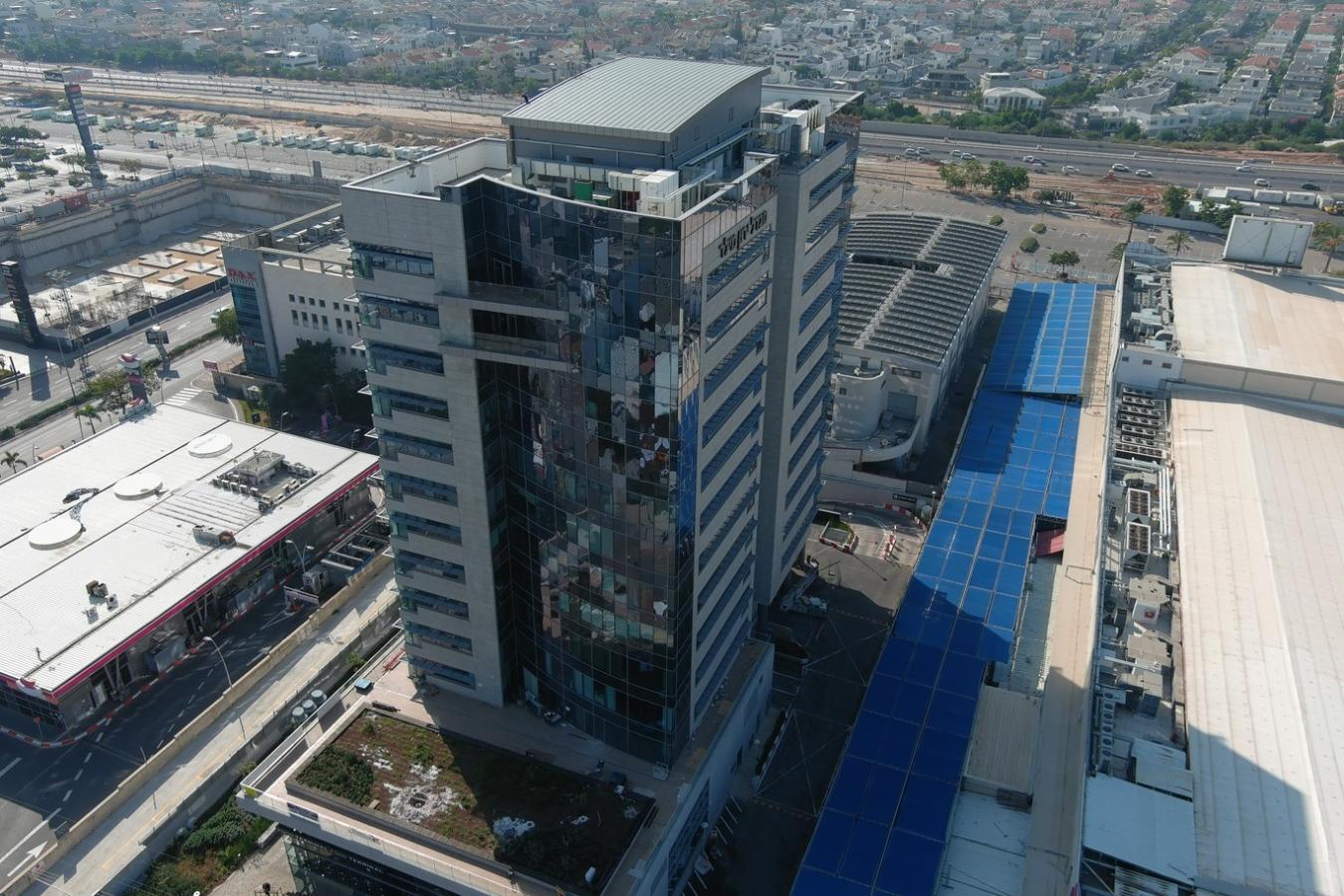

    im using general default parameters for 3d model generation but for structures/building having glass/reflective/transparent façade the 3d model is not coming good can you suggest what settings to be used ?
    these are some of the resized images
    original images are of high quality and around 2000 nos

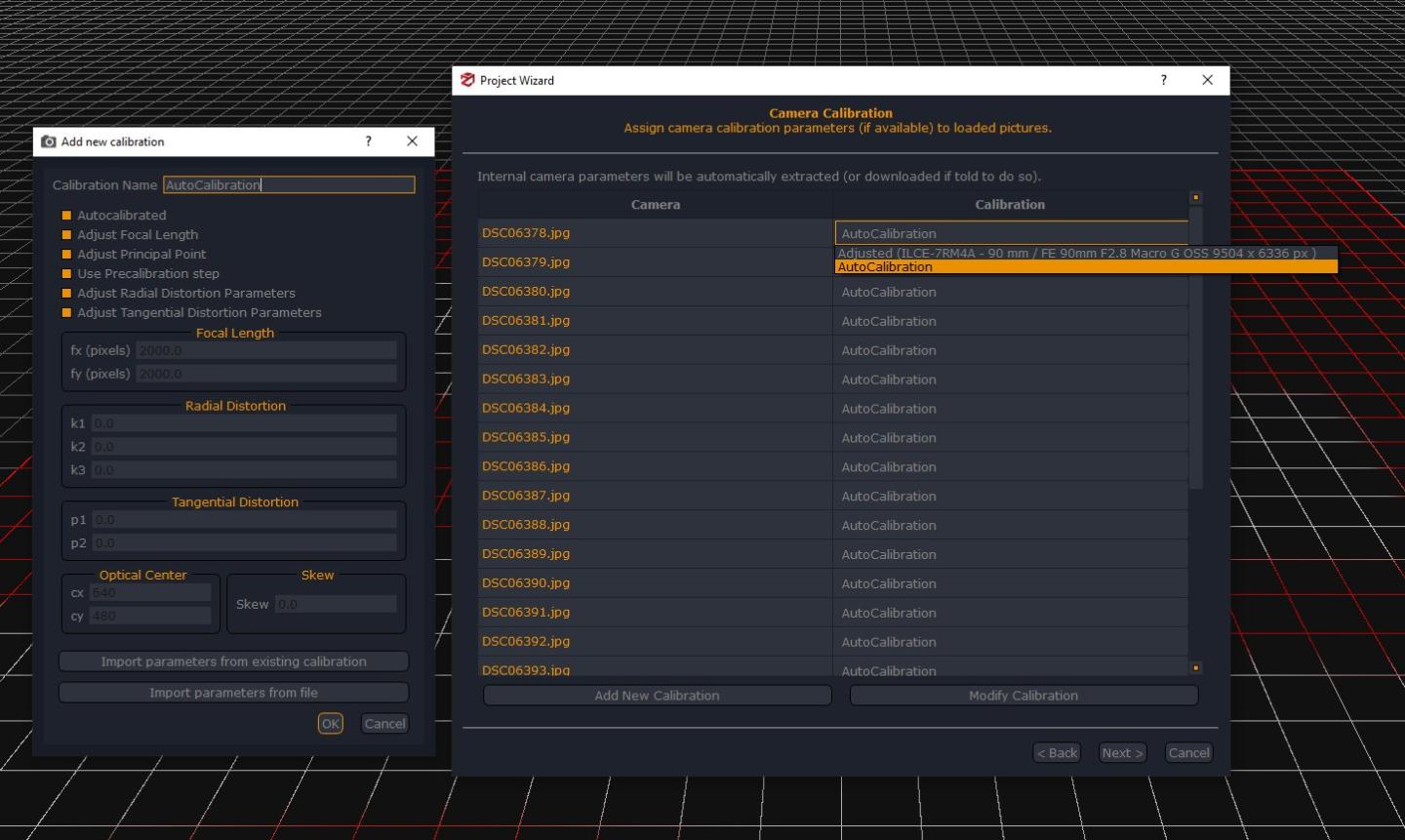

    - It might be that your image calibration is a bit off and causing issues, try changing the calibration on all images to 'automatic' (reference image attached)
