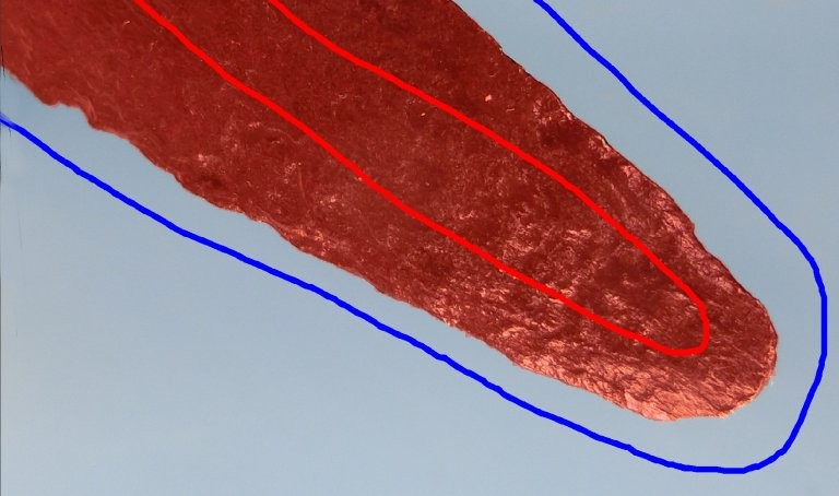

    When using Masquerade to create masks with only the red stroke and blue stroke tools, I find that the software gives us a lot of false negatives, especially at the edges of the sword, the area where we need the most detail in our model, and the area that it seems to be most problematic for Zephyr to create a good model. The tools create masks that often miss parts of the edge of the sword.

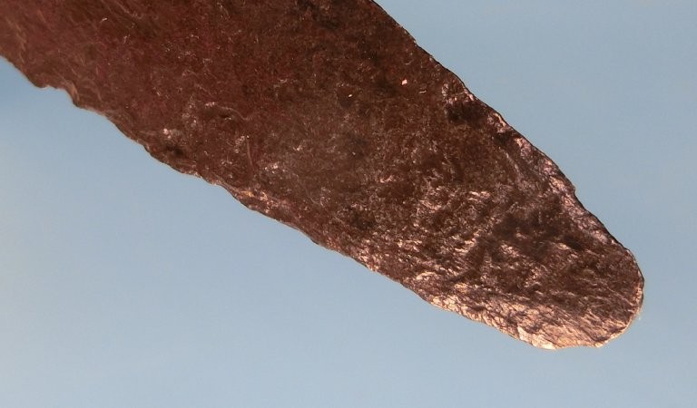

    Here's a screen shot from Masquerade showing a portion of one of the images at the tip of the sword before masking.
    Using the red and blue stroke tools gives me this mask, which misses some of the point

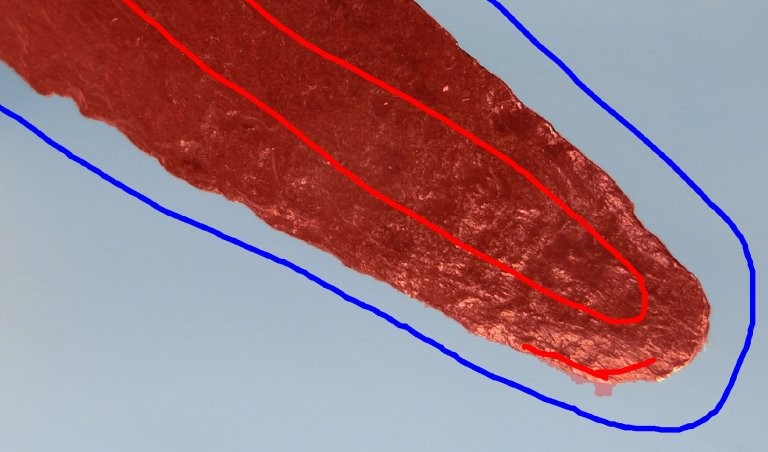

    If I try to refine the mask using the stroke tools, often Masquerade will mask the edge, but also include some false positives, masking a part of the background as an area to process.

    Two questions:
    Is there a better way to use Masquerade that will make it more likely to get an accurate mask?
    And if there is an error in creating a mask, which is more likely to create problems for Zephyr: a false positive (including part of the background) or a false negative (rejecting part of the object)?
    Thank you.?
    Hi William R. Short -
    To answer your questions:
    1. Mask by colour is by far and above my favourite masking approach! https://youtu.be/_kDCCi84F4c
    2. Generally speaking masks don't need to be perfect, especially if they are being used only for the camera orientation phase of processing - Better to omit all background and a little of the subject, rather than the other way around. As you have multiple perspectives on the subject, anything culled on subject by one mask will likely be covered by another :-)
