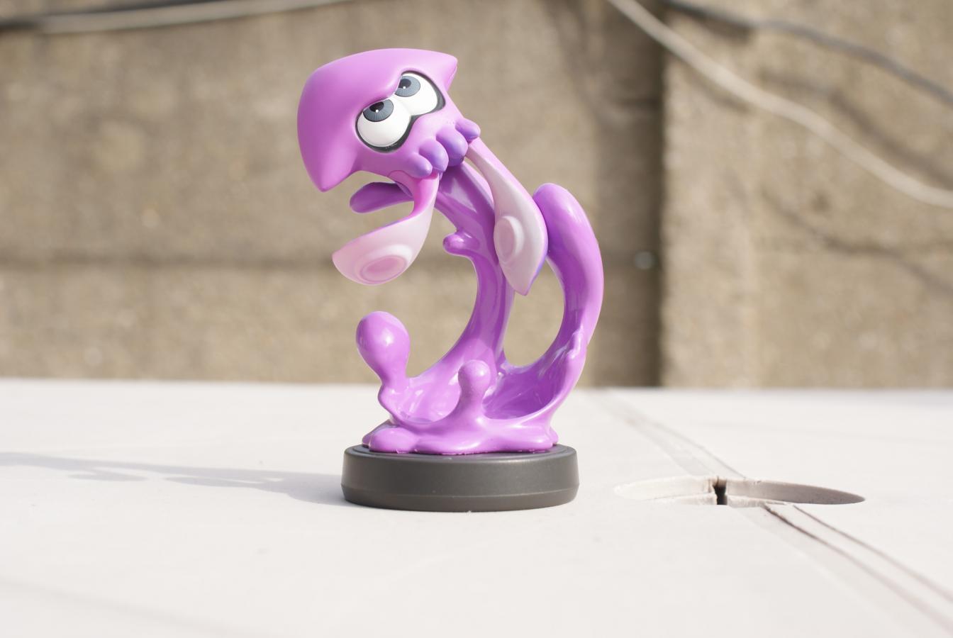

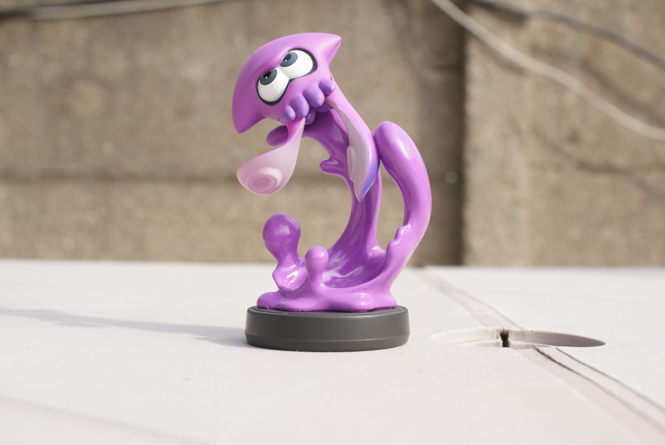

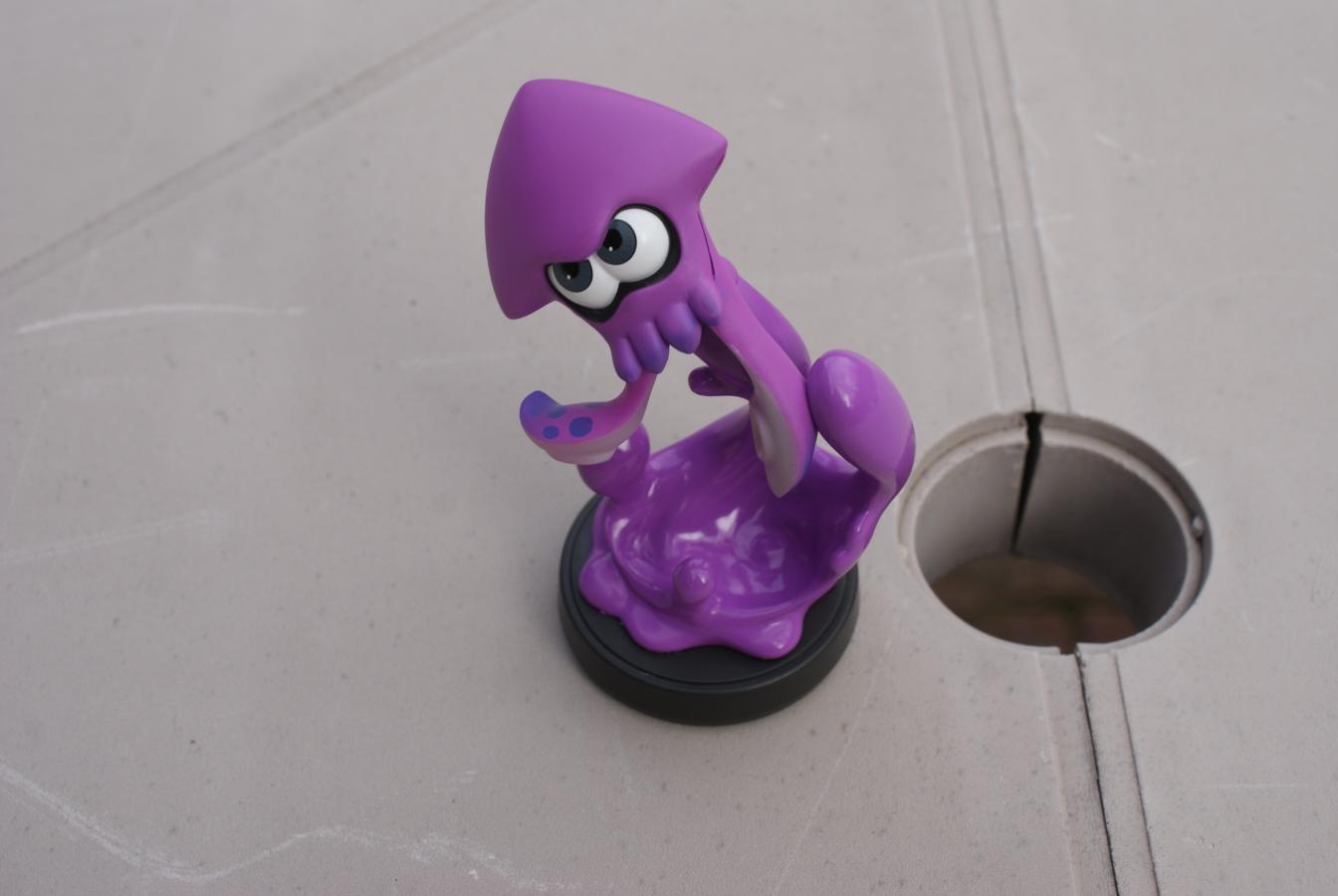

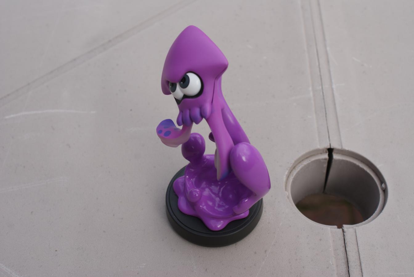

      Hi Andrea, here you can find 4 samples of this dataset. Thank you.
      For example DSC01287 and 88 are not recognized on the reconstruction process ( too much brightness i think, DSC01312and 14 are OK.
      Not recognized ->
      Click image for larger version  Name:	DSC01287.JPG Views:	2 Size:	60.6 KB ID:	876Click image for larger version  Name:	DSC01288.JPG Views:	2 Size:	60.1 KB ID:	877
      OK ->
      Click image for larger version  Name:	DSC01312.JPG Views:	2 Size:	60.1 KB ID:	878Click image for larger version  Name:	DSC01314.JPG Views:	2 Size:	61.5 KB ID:	879
      Perhaps this work on a lightbox studio with a diffuse and cold light could help me to have a clean model to reconstruct and as you say : dirt the object or applying flour on it.
        A lightbox might actually be worse, as the lights would shine and create highlights on glossy, uniform surfaces.
        I assume using flour is going to be a problem if you need the texture.
        The first thing i would try to do is try to reshoot the images, but this time put a newspaper on the bottom, and try to always have the newspaper in your frame: this will help zephyr in the camera orientation fphase.
        As for the dense cloud generation, you will still have some issues, because the surfaces is very neat and uniform, so i'll expect some noise. That said, i think you should be able to extract something. Try as i said above, and also try to minimize the highlights (no flash, no direct sunlight : make sure to shoot images with diffused lighting).
        If you dirty the surface, you will get a better geometry (for example by spraying it with flour, or by projecting a pattern onto it).
