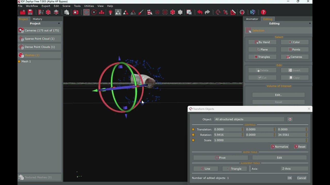

    Just upgraded to version 7.3 and wondered if anyone else having these same issues. We have a 3D mesh that we are trying to rotate and align with the grid. The workflow in the prior version was to use the Transform Object tool to change the orientation of the object and the XYZ coordinates in 3D space. However, in this new version, when pressing OK to accept these changes, this doesn't seem to work. The rotation changes are applied, but the object does not remain in the position it was moved to on the grid. (In other words, rotations are applied but translations are not. It is also worth noting that the viewpoint reverts to the original angle as well.) I've included some screen shots to illustrate.
    1. Mesh is not oriented correctly. Turned on scale/rotate/translate to adjust.

    2. Used tool to rotate the object and align with the grid. (This also changed viewpoint of object)
Name:	Screenshot 2023-03-06 135051.jpg

    3. Pressed 'OK' to apply changes. Viewpoint reverts back, rotation changes are applied but object removed from position it was placed on the grid.
