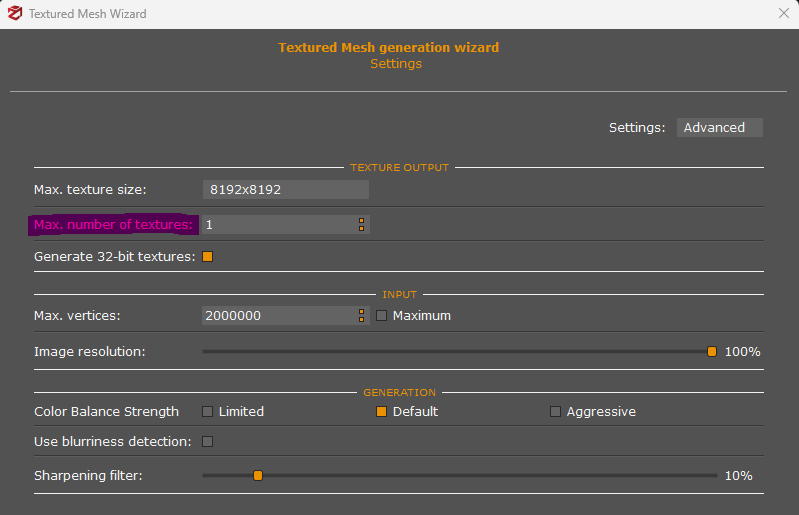

    Hi levart - In this context high precision textures refers to 32bit texture generation - To do this head to the advanced settings when setting up textured mesh and tick the box which says: 'Generate 32-bit textures'.
Name:	Screenshot 2023-07-24 125909.png
