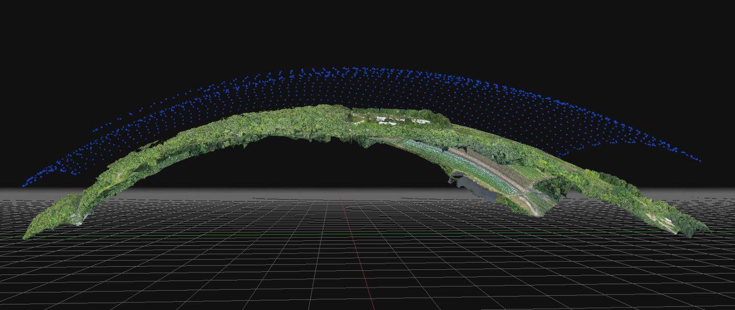

    Having an issue with how the software is interpreting camera position
    Hello, I haven't had this issue previously. Recently I flew a DJI Matrice 30 and did a mapping run of a farm. I noticed that when the 3Dflow Zephyr software was rendering the land such there was an extreme curvature to it. I did have RTK enabled during flight. If you look at the image I posted, the rendering of camera in space location has an extreme curvature to it. How can I fix this? Can I fix this post rendering the project and have it correct itself?

      Thanks for getting back to me. I am using the Category "Aerial - Nadiral images" and default presets. I will send support@3dflow.net a zip file that contains all the images taken with the DJI Matrice 30. I've been using this drone for previous mapping and I did not notice an extreme curvature to the rendered map. It could also be that the farm was large and the curvature was more apparent. .

        Hi ngl1145 - Thanks for sending through the images. I ran them myself with exactly the same settings (Aerial - Nadiral Defaults Zephyr 7.021 and had no issues with curvature (see attached image).
        If you go to Tools>Options>Application you can delete the temp directory - This could fix the issue. Also make sure you're using the most recent Zephyr release so we are on the same page for further troubleshooting :-)

          Thank you for processing the files that I sent. I'm glad to see that you were able to get a flat render (which is what it should look like). I did confirm that I am running 3DF Zephyr Lite 7.021. I also went to Tools>Options>Application and deleted the temp directory. I'm still getting a warped perspective.

            When it comes to the camera calibration step, did you touch anything or did you just use the defaults? When I did the last render, I didn't touch anything and it looks like a potato chip. I'm baffled by what is causing this. Each render takes a while to output the image so I feel like I'm burning a lot of time trying to create my image. I feel like it's a software setting.
              • 702
              ngl1145 - I just did a factory reset on my Zephyr installation and it worked fine, can you try that and see how it goes (Tools>Options>Application) - If it is still causing issues please send through the .ZEP project file so we can troubleshoot further.
