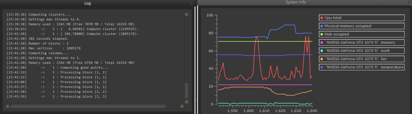

    Hi, at the end of dense point cloud in log window i see the massage " Settings max threads to 1 " , i have uploaded an image here, is there a reason for that or can i edit the max threads to more in settings in somewhere ?
    Hi hamed.desighn - Some processes are single thread operations, others can utilise multiple threads simultaneously - As far as I'm aware this is one of those instances, where computing volumes is simply a single thread operation, whereas computing clusters, for example, operates with multiple threads.
