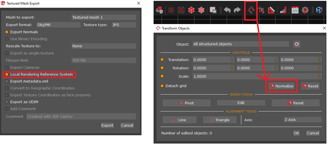

    it looks like your project is saved with double precision. That is necessary for georeferencing the project and other deliverables (e.g. orthophoto) and is automatically added if your dataset has GPS information, which is likely what happened here.
    Not all 3D software supports georeferencing.
    If you don't need georeferencing, make sure to either pick the "Local Rendering System" option in export or (better, in case you plan in re-importing your model in zephyr after changes in blender e.g. for unwrapping) you want to normalize the workspace without using georef information. After you have normalized it, you'll be have manually redo georeferencing, if necessary.

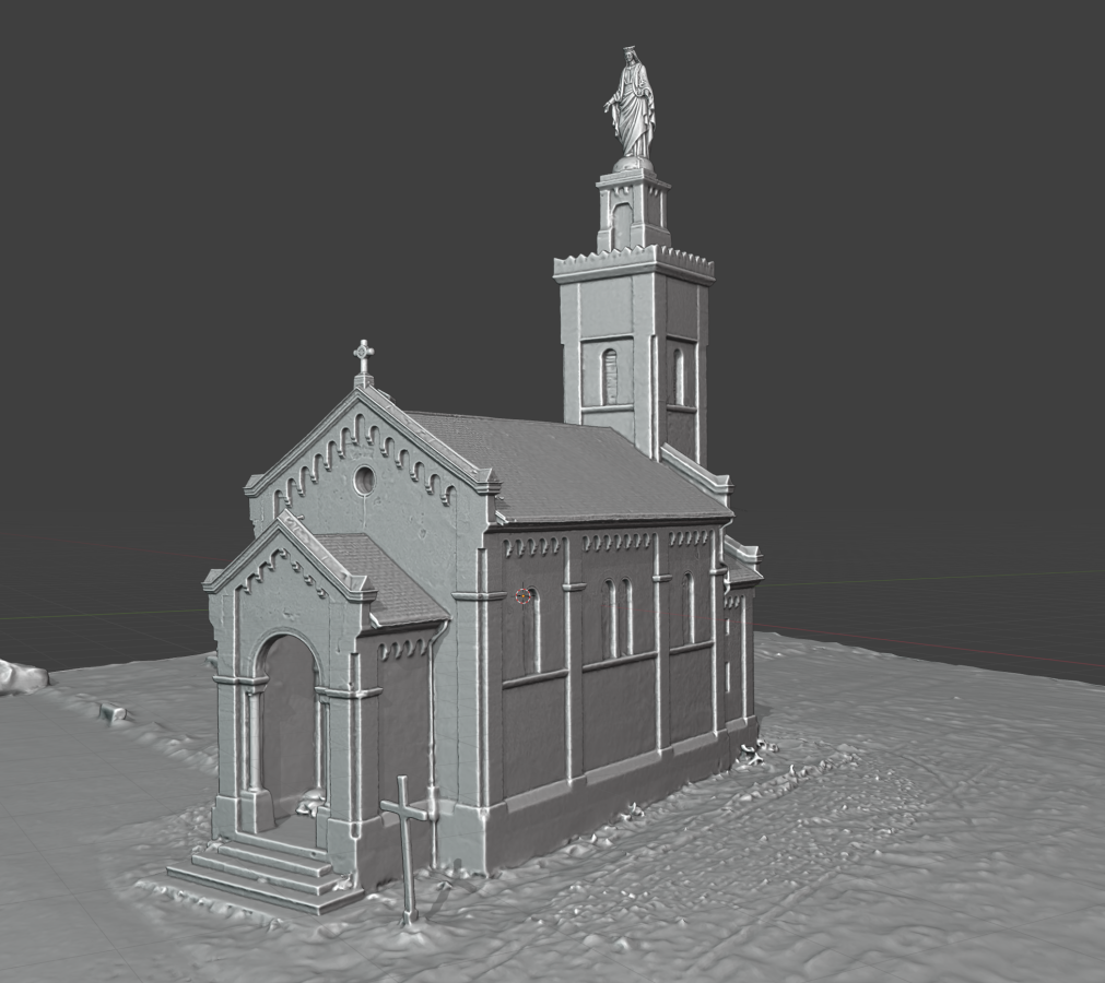

        Voilà !!! it looks pretty nice!
