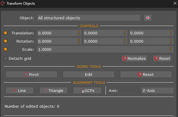

    Uncheck 'Detach Grid' in the Transform Objects floating window:
Name:	Screenshot 2025-05-12 133043.png

      Hi, Thanks, will try that. Pity it wasnt as such by default.
