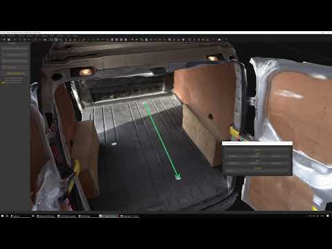

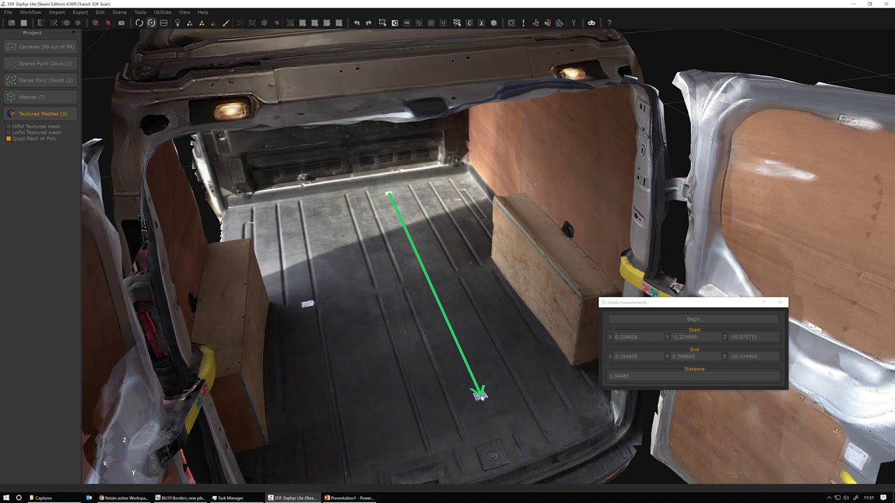

      Hi Roberto
      I've made a quick screen recording showing the issue while the Measure tool but it's the same with the Plane Vector tool. Zooming is actually okay on it's own but panning stops the active tool.
      I'd find it useful to be able to orbit/pan/zoom while the workspace tools are active for selection accuracy. For example I'd like to be able to level a mesh from a known feature (a building's damp proof course/plinth etc) picked from opposing elevations using the Plane Vectors tool.
        Hi Sam,
        I confirm it's a bug, thank you for reporting it! We'll fix it in the next release.
        In the meantime, as a workaround, use the WASD navigation rather than the orbit/orbit pivot navigation to obtain the desired behaviour.
          Filippo fixed it in the current beta build thanks again for reporting!
