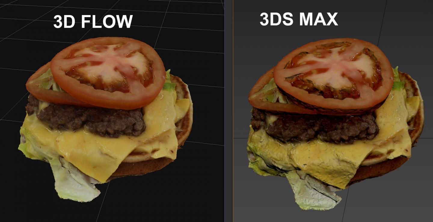

    Here is the result of my photos in 3D flow - the Textured Mesh and the same Textured Mesh as displayed after export into 3DS Max
    Why did I lose the smooth cheese and other features here to be more rough looking? I did export the textured mesh and was expecting something similar
    any ideas?

    Ah, check "Lighting" in Zephyr, you will likely get the same view.
    As a default it doesn't illuminate the polygons directionaly, so it looks flat. When you turn on illumination, the direction of the polygons shows up.
    To produce smooth lighting across the polygons, you need to use the right shader on your model inside the 3D modeller, and also you may need to specifiy "Smooth shading" in your 3D app. (Blender for example lets you set the normal calculations to produce smooth lighting effects like this: https://blender.stackexchange.com/qu...smooth-shading )
    If you want the mesh to be smoother by adding more polygons, you can do that in Zephyr:
      Hi Cg-Guy,
      as Sarah pointed out you simply were looking at your mesh with the lighting off. It's always a good idea to also completely see the resulting mesh without color/texture (use the three colored triangles icon in the toolbar to toggle it) to see the actual mesh detail.
      Also make sure to check out these two (very short, i promise) videotutorials. They go through mesh filtering and how to also apply filters on a mesh sub-selection.
      These are basic stuff compared to what you can do in blender or other professional tools, but are a good starting point

        Thanks for the help

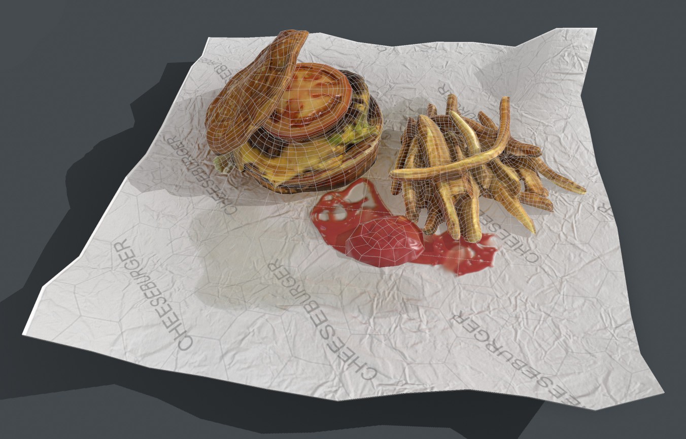

ID:	2397 Here's the outcome thus far on the cheeseburger - low poly with PBR textures
                        I've been busy on other items - I still am planning on creating the foil paper to set it all on and globs of ketchup and mustard

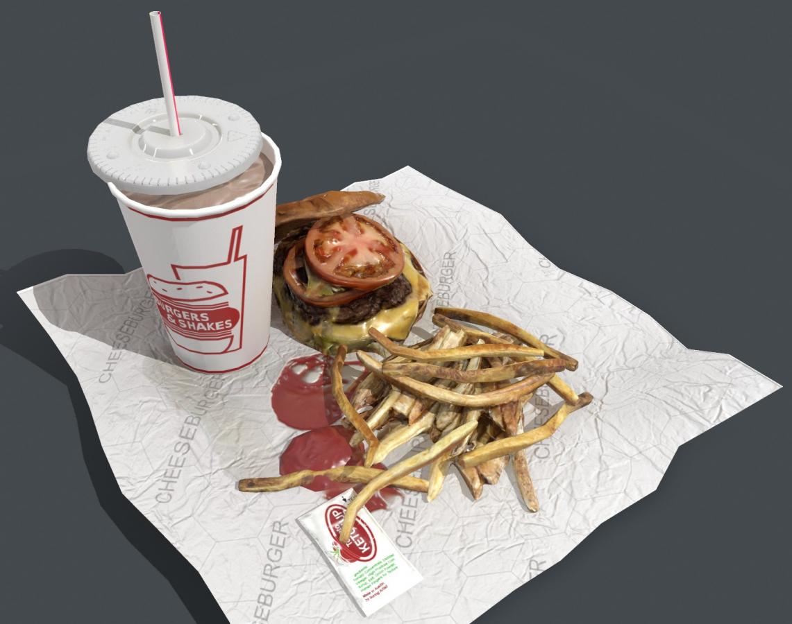

                            Here's the final real-time model as a result of 3D-Flow workflow - cup, foil, ketchup and some single fries were hand done with traditional ways
