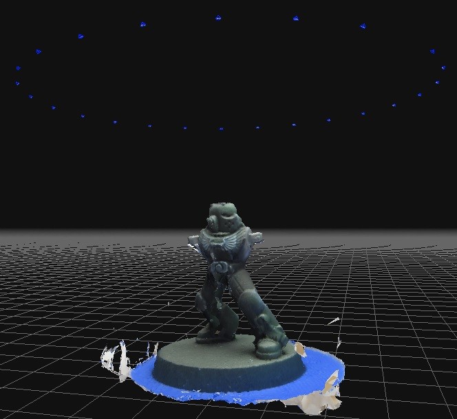

                I tried 2 orbits of 25 photos each using a similar model that would not have as much of a problem with depth-of-field. The 'head-on' orbit was rejected entirely by the software but the '3/4 view' was fully reconstructed. The photos are at the link below:
                I'm unsure as to why one orbit would work better than the other. I've also noticed that this was the first time the photos were properly aligned as shot by the camera. Normally, if the reconstruction doesn't fail outright, the photos are all bunched up on top of each other. Does the software determine photo alignment based on photos that have 'passed'?

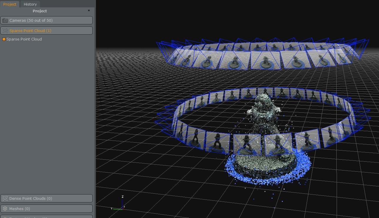

                  - when using a turntable, always use masks. If you also use the "turntable mode" in masquerade, it will only take a few minutes. It took me 4 minutes to mask your dataset and it's always a good idea
                  - try to shoot in manual mode. Some of your images are shot at 1/250 sec, some other at 1/80 sec etc, which creates different lighting settings. While zephyr is robust to light changes, it's always better to have it as uniform as possible in your dataset, and since you are in a controlled environment you should aim to have the same lighting in all your images.
                  - try to use a lower iso. Always aim for ISO-100, use a tripod with remote and longer exposure to get better results. higher iso means higher noise (especially with consumer grade cameras), which leads to worse results in zephyr.
                  - If the two orbits are processed succesfully separately but zephyr is not able to create one single block, most likely you don't have enough vertical overlap. That's fine though, as you can easily fix this by simply taking a few shots that go from the bottom orbit to the top orbit. Or you can simply try increasing the parameters if processing time is not an issue. Even by masking i got 25/50 with close range/defaults, but moving to close range/deep succesfully allowed me to get 50/50. As you can see masking is essential in this turntable setup.

                  - below is my result from your dataset.I simply processed down the pipeline, so no editing at all (although i could remove some noise from the dense cloud i guess) If you can get sharper photos you will get much better geometry and much better texture. You can find some tips and tricks on photography for photogrammetry in this very short videotutorial.
                  Parameters used:
                  SfM: Close range/deep
                  MvS: Close range/defaults
                  Mesh: Close Range/defaults - sharp features
                  Mesh: additional photoconsistency run (clone & apply) with bad mesh/bad photos settings and fill holes filter, as the mesh had a lot of noise.
                  Textured mesh: defaults + blurriness check
