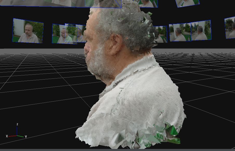

    generated mesh with "spikes"
    Hello. I am trying your software (free version). I follow the workflow steps not changing any parameters.
    In the final stage (textured mesh) I get a model that seems to have spikes on it.
    What can I do? What parameters must be changed?
    Do you need that I send the files?
    Thank you.

      The zep file is 320M and I cannot sent it in here. Is there any other way? attach screenshot
        from the second image it looks like some cameras are not oriented correctly (the face looks "misaligned"). Did you use a fixed rig or did you move around the subject? If so, then most likely the subject moved and this can make a dataset unusuable.
        If that's the case, i suggest you try taking a video rather than photos, as it will be much faster and that would minimize movements. Here is a great tutorial from Nick Lievendag's blog https://3dscanexpert.com/free-3d-sca...eo-smartphone/
        If you want to share the dataset, you can either send it via wetransfer to support@3dflow.net or i can contact you privately, let me know!

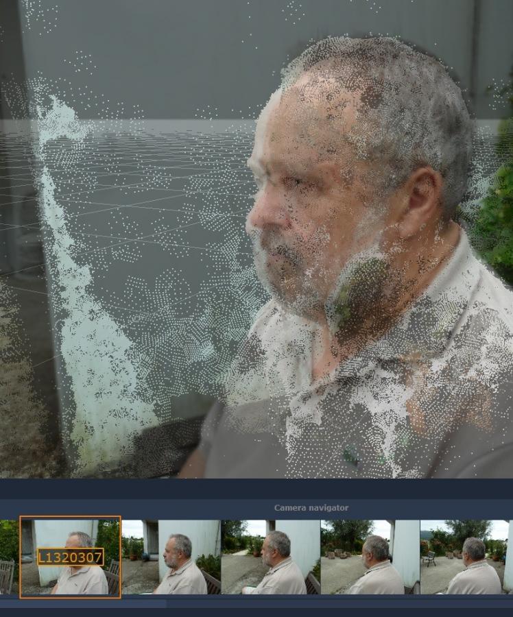

            Hi rogerio,
            i had a quick look at your Zep file. The issue you are facing is definetly given by some cameras not oriented correctly or you moving while the dataset has been acquired. This is easy to see if you overlay your photos with the 3D reconstruction (simply click images in the camera navigator)
            However, without the original images it's very hard for me to see if you actually moved or if zephyr wrongly computed the camera position (it may happen sometimes). However i think you moved a bit, as this error is pretty common regardless, if you wish to also share the images, i'll happily take a look at them too.
