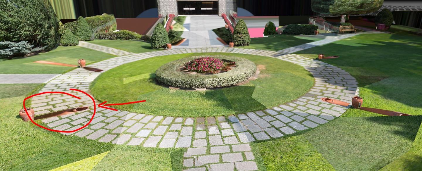

    Hi JuanGea -
    Are you able to share the mesh files through google drive or something similar? It would help with identifying the root cause of the issue Also please post your texture settings, thank you!
    - Cam
    • JuanGea
      • Sep 2018
      • 14
      cam3d
        Hi Juan,
        it's super odd that you get a crash, so i'm afraid there must be something particular with your mesh that zephyr doesn't like (make sure it's tris and quads only, ngons are not supported).
        The fact the the vase is projected is probably because you have no visibility with the sub-selection of the cameras you made.
        You can send me the project if you like and i'll have a look!
        • JuanGea
          • Sep 2018
          • 14
          Is there a way to pack the project with everythign and send it back to you as an archive?
          I had to select some specific cameras because when I leave all the cameras it crashes too
            You can zip everything (zep, image, lowpoly mesh) and wetransfer it or send me a dropbox link. If you want i can open up a space on our server for you to directly upload everything
            • JuanGea
              • Sep 2018
              • 14
                it would be better to have the obj as well, just to make sure nothing gets lost, if possible
