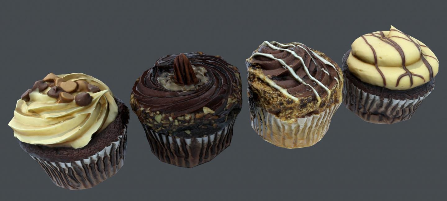

    Cupcakes
    First 1 of 6 variety
    This is the High poly will make a real-time piece out of it as usual

  • AvionAvionics
    • Nov 2017
    • 76
    Looks like it came out nice, mind sharing some details like number of photos, high settings,low settings?
    • CG-Guy
      • 151
      I have several lights and use turntable with switchable black and white backdrops
      Using canon 80d with manual focus iso 400 f22 or something I think
      Lens I'll have to look
      • CG-Guy
        • 151
        I think it was 30 shots roughly including upper angle and side so about 15 each angle then used masquerade for quick masking
        • CG-Guy
          • 151

ID:	4118 Here's the low poly versions using PBR maps - not final - just 2 cupcakes processed with my workflow

                    • Victor Ramamoorthy
                      • Jan 2019
                      • 64
                      Wow, that is awesome work! You blew my mind!! Can you also make physical measurements of the cup cakes? I mean like volume of the icing and cake dough, etc?
                        • Jan 2019
                        • 64
                        One question: What is PBR maps?
                          All reconstructions are initially at an arbitrary scale. You need to bring first the reconstruction into a known scale. Best way to do it is using control points (Zephyr Pro and Zephyr Aerial only) or you can use this trick in Free and Lite (albeit much less accurate): https://www.3dscanninghacks.com/wiki..._Free_And_Lite
                          Once the reconstruction is scaled, you can use the normal zephyr measurements tool available in Pro and Aerial (including distance, area, volume, etc) or use any other software to measure an exported mesh.
                          PBR stands for Phisically Based Rendering: you can find a quick overview here https://en.wikipedia.org/wiki/Physic...ased_rendering
                            • Jan 2019
                            • 64
                            Hi Andrea, Can the scaling be improved by placing a three dimensional physical object with known dimensions in the scene and calibrating scales for each X, Y, Z dimensions?
