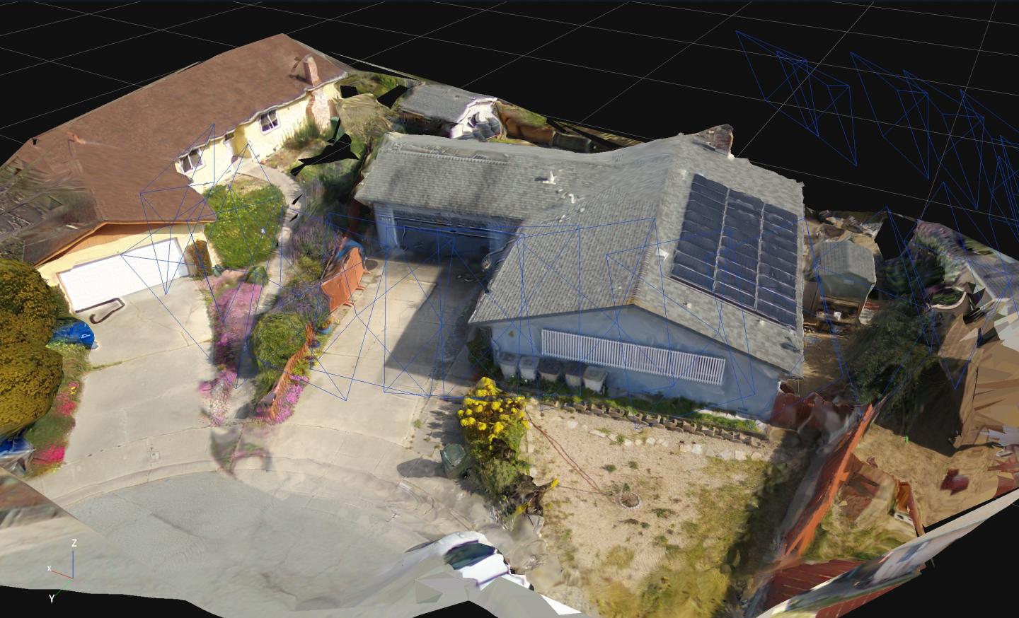

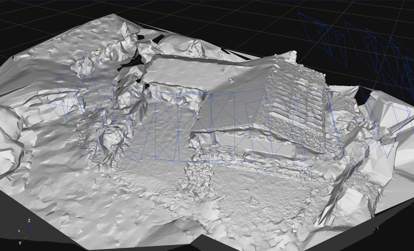

                I've now had a chance to review your images - With the alignment preset 'Aerial>Deep' I was able to align 19/35 images. Dense preset 'Aerial>Default', used the 'Editing>Selection' tools to cut away the excess points, then meshed with 'Aerial>Default' and textured with a single texture map:
ID:	4913Click image for larger version
                When your images don't align with one preset, I advise that you incrementally step it up to the next level of alignment settings - This should yield better results, though it's always advised to re-acquire data which aligns with the default settings (if possible), as this tends to give you the best results.
                If you were to re-shoot this, I'd take more photos directly above the house. and maybe get a little bit closer if possible?
                Hope this feedback was helpful!

                  Very much so, thank you. In the interim by selecting "Aggressive" while matching cameras I got several more aligned as well. I'll try that preset. I can get closer, but this was literally the first set of flights I have made with a drone ,so I was being cautious. Thaks for the lesson.
