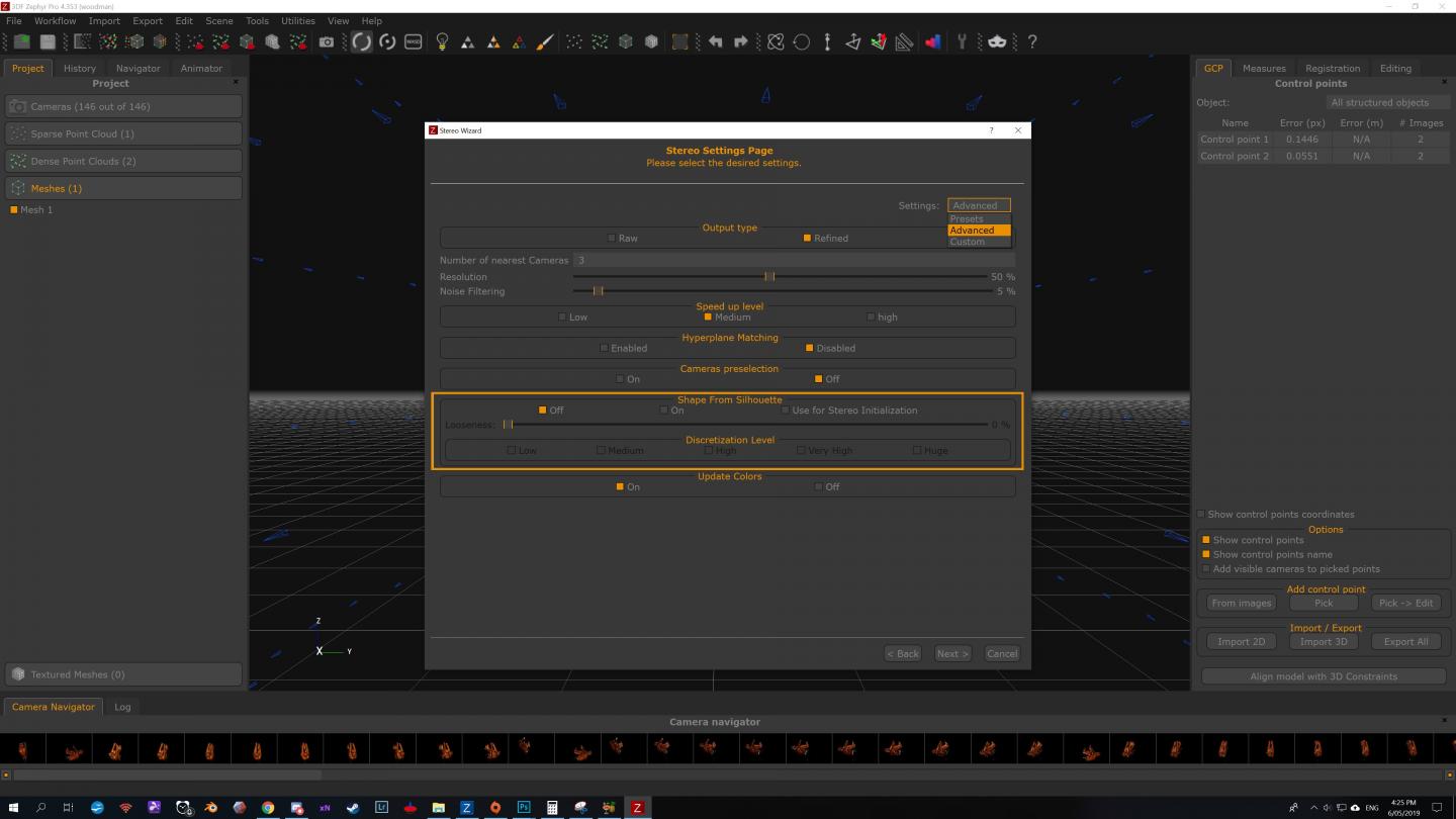

    So I've downloaded the trial for Pro 4.353, but the web tutorial that I'm finding for doing shape-from-silhouette modeling in 3DF Zephyr Pro seems to be out of date. On the project wizard settings page, the layout is different, and there is no advanced option page that show the SFS controls found in the tutorial.
    Can anyone tell me where I can find these controls? I'm trying to evaluate this software for some research I'm doing, and it has to be able to make SFS objects using masks that I've provided. My masks load, but I'm not seeing the controls I need to complete the processing.
    Hey SandWyrm which web tutorial are you looking at? https://www.3dflow.net/tutorial-shape-silhouette/ is the latest one (to the best of my knowledge).
    Just downloaded 3DF Zephyr Pro 4.353 and checked - I've highlighted the controls and how to get to them:
    (It's in the Dense point cloud generation settings)
