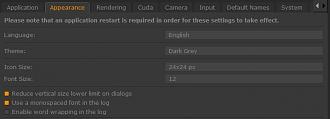

                    Hello,
                    Just a note to say that we have squeezed into the last minor patch, an option to remove the lower resolution bound. The option can be activated from the options->appereance menu:
                    Please let me know if this helps with your configuration.
                    Best,
                    Roberto

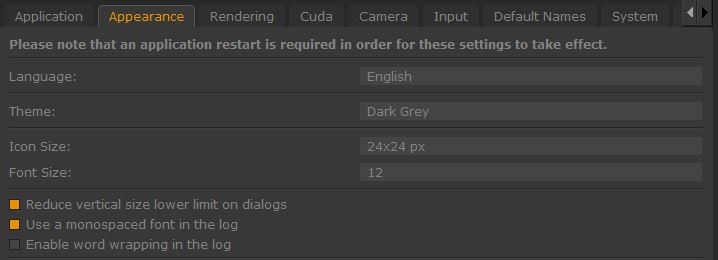

                      I have the exact same problem. I have a new laptop, haven't adjusted any resolution settings on my computer. My screen resolution is by default 1920 x 1080. However when I open 3DF Zephyr, everything is huge and the buttons on dialogs are cut off. I don't have this problem with a single other program.
                      I've attached how the screen looks when I first open the program, and when I open the Options. You can see that the font and everything is enormous, very strange. Even after I clicked the checkbox "Reduce vertical size lower limit on dialogs" I still can't reduce the size of the popup window. I would have considered buying Zephyr but if I can't even get the program to have a reasonable UI that's out of the question.
                      Hope you can post a fix real soon!

                        Note: I am on Windows 10.
                        My temporary and suboptimal fix was to go to the program executable, right click, select "Properties", then under Compatibility>Change high DPI settings (see attached).
                        I checked off this box:
                        "Override high DPI scaling behavior. Scaling performed by:" and selected "System (Enhanced)". Now when I open the program it looks like the screenshot attached, much better.
                        Still, it's kind of annoying that I had to do this and it still feels like the fonts aren't crisp. Very hacky.
                        If anyone also has this problem and has a better solution I'd really like to know.
