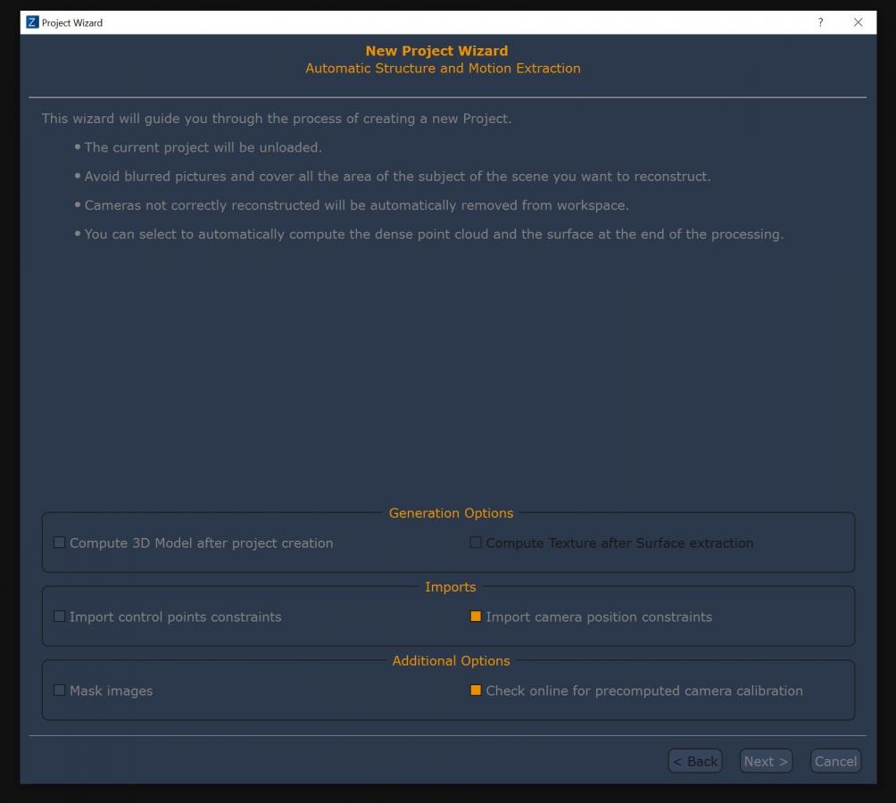

    Hi 2bForgotten - Just checked it out for you with some DJI drone data with embedded data - everything seems to be there on import (WGS 84 etc...) - just make sure you tick on 'import camera position constraints' when you're starting a new project. Let me know if you have any specific questions
    Click image for larger version  Name:	example.JPG Views:	0 Size:	54.7 KB ID:	5851
