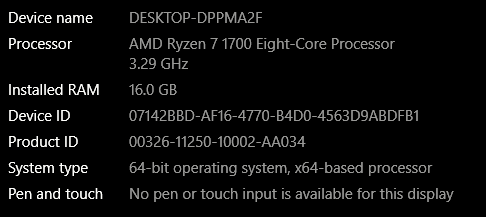

    My computer has crashed twice when trying to build the first Mesh ( not textured mesh ) .
    My computer specs:
    Free Disk Space 127GB
    Windows 10 Home

    [18:49:03] SysInfo | Cpu: 6.14 %; Disk (U/T): 1965400/2096111 MB (130711 MB free, 93.76 % used); Memory (U/T): 2360/16320 MB (9274 MB free, 14.46 % used)
    Model Images Details:
    # of images: 1449
    Each image size about 2.5mb
    When I restart the autosave file doesn't have any of the mesh build work done.
    Thank you for any suggestions on how to get 3Dflow to finish the mesh build!

          ThursdayJuly23rd - sorry for the late reply! Didn't notice your response until now. Thanks for sharing the log file, it looks like you are running out of RAM - For high levels of detail or large image counts (or indeed both) you will need plenty of RAM to ensure things run smoothly. I'd strongly advise an upgrade from 16gb to 32gb or greater to ensure you have headroom for bigger projects.
