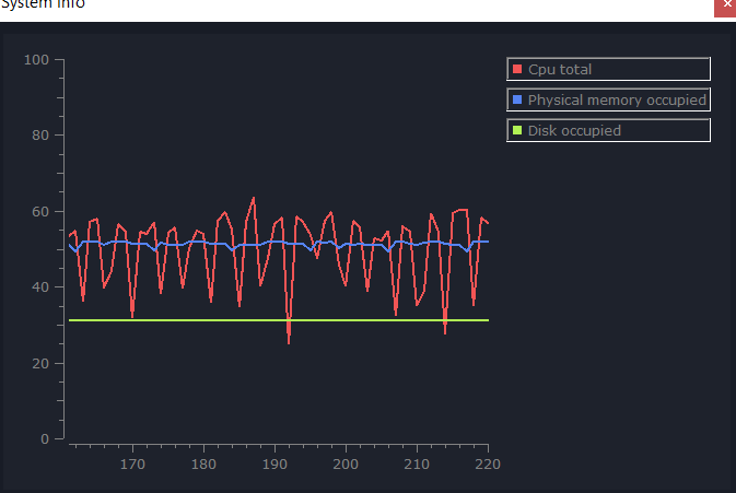

        here is how it looks like. it usually has 2 more lines in this statistics as far as i know, one for GPU temp, and one for GPU usage, but it is not there anymore. i do not know what i did wrong

              Thank you for the log!
              While Zephyr in the GPU shows it is indeed using it ( see the [GPU 0] rows ) there is this error on startup
              [00:58:14] Init NVML failed! [error 999]
              This indicates a driver issue on your machine. Is this a virtual machine running under linux? If so pay attention not to mix a package driver with a runfile installer for the nvidia drivers. This is just a wild guess on my part, by looking at similar issues on the nvidia developer forum.
              Regardless, this particular error is a driver issue so I would recommend deleting the nvidia drivers completely, rebooting, and re-installing them.
              I hope this helps!
