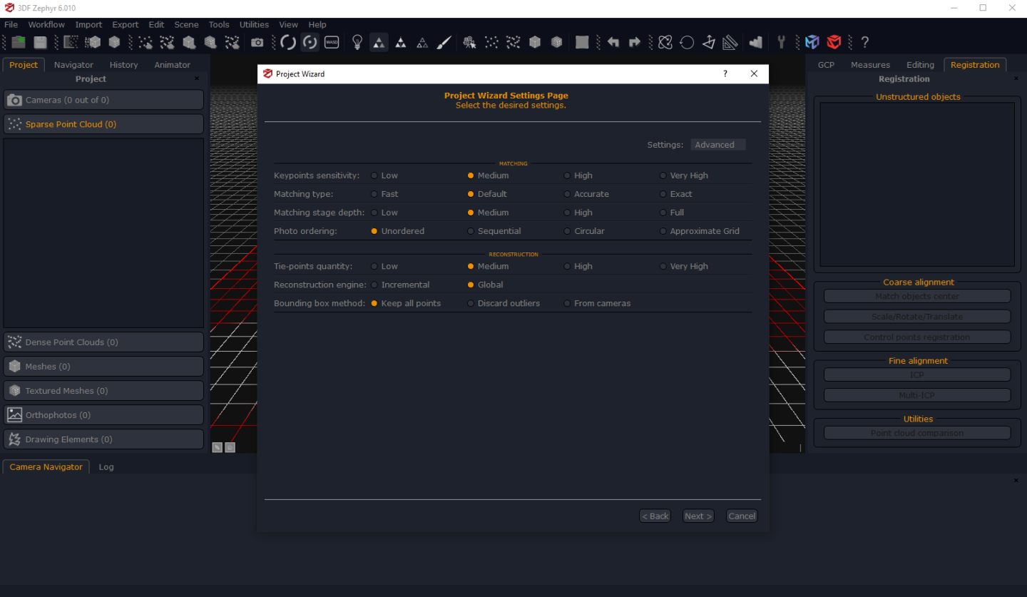

    Malmakil - It's most likely the bounding box cutting off the feature poor cubes and discarding the data. You can change the bounding box method through the advanced settings in the project wizard. I've attached an image for your reference:
