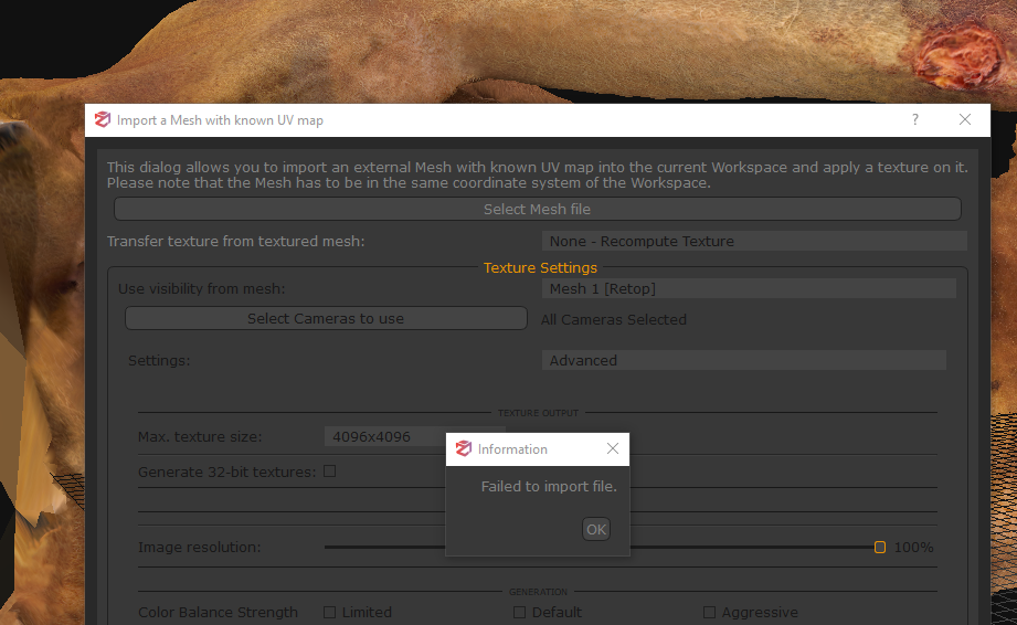

        I have a mesh that will import into Zephyr via "import model" - it aligns with a textured mesh I have exported and re-imported. I want to project the texture from the textured mesh to the UV model. However when I try to import mesh with UV I get this error (yes the mesh has UVs)

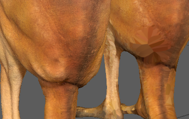

              This is the exported/imported textured mesh and the imported model - they line up pretty well - but how do I get the texture onto this model? I just want to reproject it from the textured mesh onto the imported model.

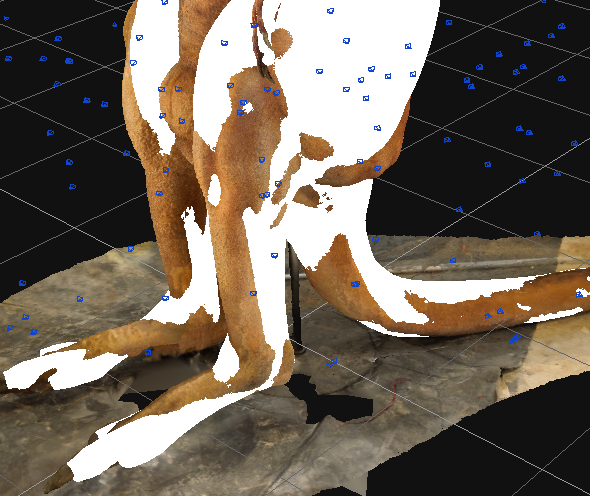

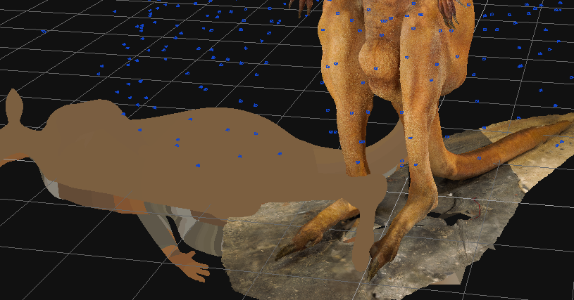

                    didn't work - I must say at this point this software has gone from being awesome and creating better pgram mesh and textures than anything else I've seen to being total time wasting garbage. If I can't export or transfer the texture in a useful manner it defeats the whole purpose of using this software.
                    edit: it appears to be the fbx importer in Zephyr is not behaving properly. I can output a model in metres and it imports at the same scale as one in centimetres. Ignores scale factor.
                    With that in mind I could fudge the transforms and get the model in the correct position

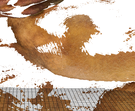

                        I corrected the obj and imported with UV, it only projected one UDIM tile
                        • CamCrichton
                          • Sep 2022
                          • 15
                          Faith restored, albeit on one UV tile. I can output 8k and manually manipulate them in PS.
