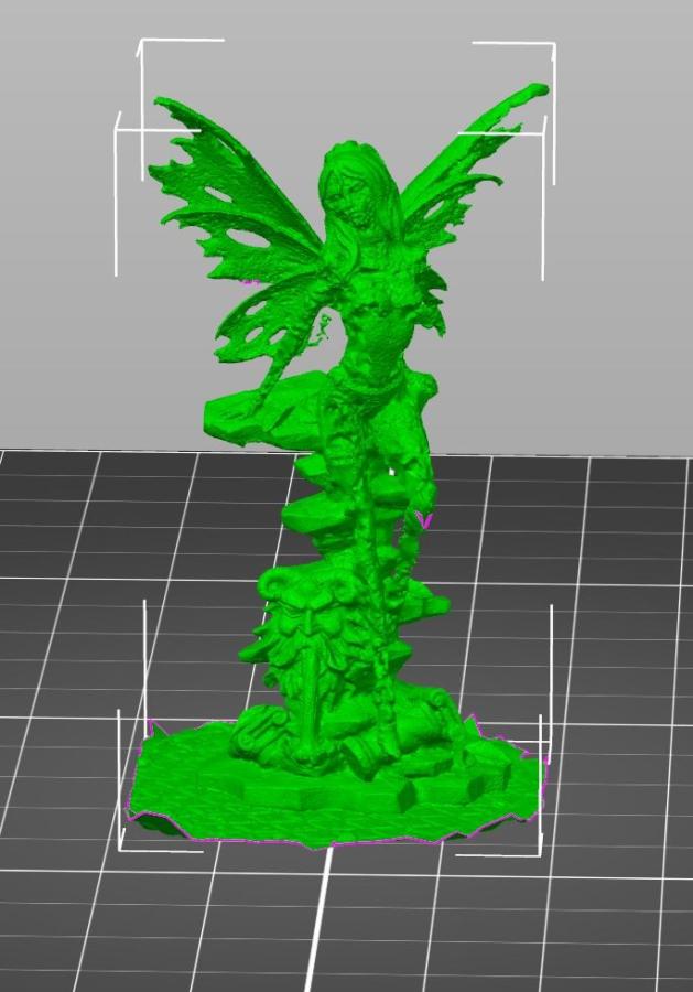

    First time user here. I have downloaded a trial version of Zephyr Lite. My plan is to use Zephyr to export STL file to my 3D printer.
    As a trial I took 250 photos of a model and went through the import procedure. All photos bar 1 was imported and processed successfully. However the result looked more like something out of the walking dead which was not expected. Obviously this was due to me mishandling the process but as the wizard was very good cant see what it was i did wrong. I tried to upload the STL file but was not allowed to.

    From what I see from your two screenshots, it seems that the cameras are probably oriented correctly (though consider adding a newspaper under the statue for example to help camera orientation) but you have some issues with the surface. With plastic/smooth surfaces this is generally an issue with photogrammetry and can be accentuated especially by bad lighting/noise on the image.
    Make sure to get good photos with no direct light, and that your camera settings allow for a sharp image with no noise.
    Additionally, you can consider masking the dataset though for this specific case I don't think it's necessary.

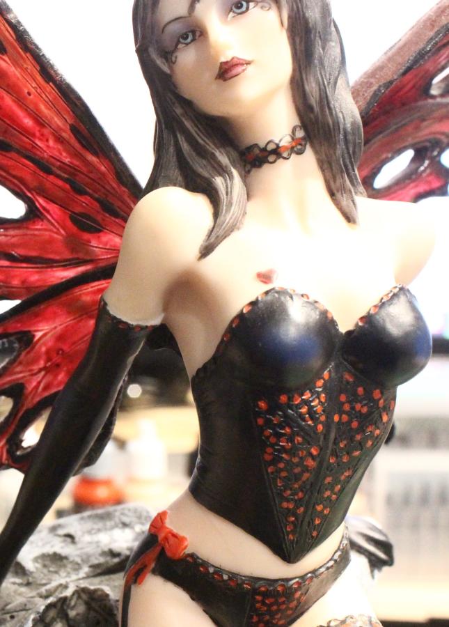

                Just a made a few adjustments and the result is not much better than previous. I purchased a light box and used a white then black background. All photos came out well but the handling of these with the application was far less than perfect IMG 6001 model shoulder was missing and again the surface was full of blemishes. Is it possible to do what I am trying to do and get a flawless file?
                I have sent the latest dataset for your consideration.

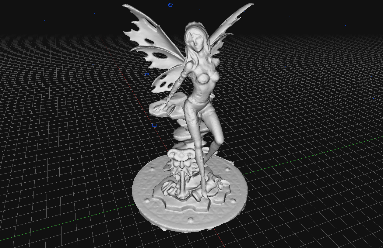

                    I did a quick test and created less than optimal masks.
                    This is my result on general/default
                    Click image for larger version  Name:	meshbefore.png Views:	0 Size:	438.4 KB ID:	9601
                    it's normal unfortunately you get some bumps in the surface as plastic is difficult to reconstruct due the lack of features (consider using a cross polarizer to minimize reflections)

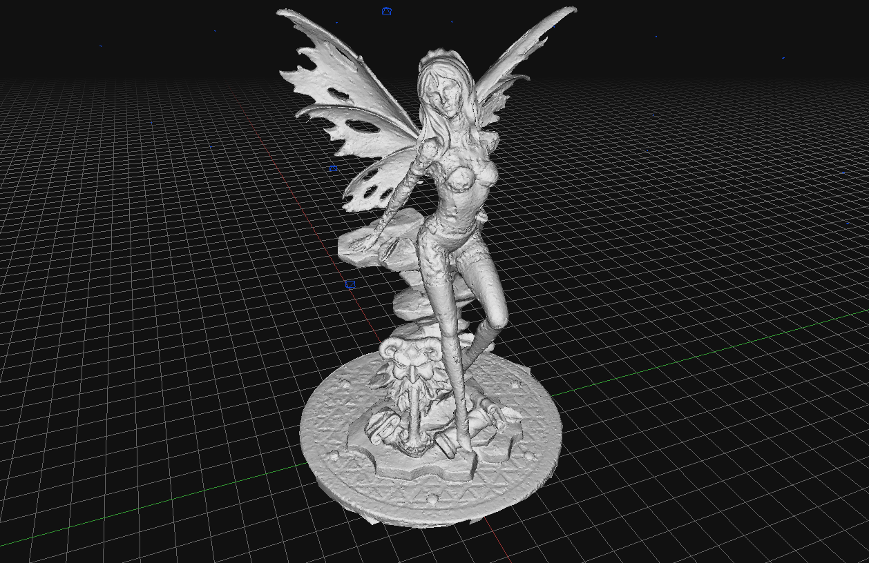

                    I've also run a a laplacian smoother filter within zephyr:
                    Click image for larger version  Name:	meshafter.png Views:	0 Size:	349.4 KB ID:	9602
                    You can probably get better results with proper masking, and consider applying the smoothing filter only where needed (as I did it on the full model, it lost some detail on the bottom part that could have easily been maintained).

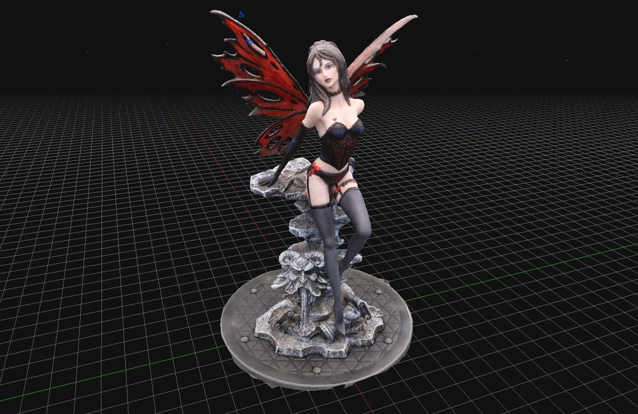

                    Eventually, consider fixing the remaining minor issues in blender and reimport the model
                    Click image for larger version  Name:	textured.png Views:	0 Size:	497.3 KB ID:	9603
                    This is just a quick result, you can certainly improve it
