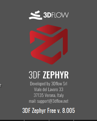

    Can you please describe more in detail the steps you take to make it crash? I'm unable to replicate your problem. Please also confirm which version of 3DF Zephyr you're using - are you on 8.005?

      Click image for larger version  Name:	image.png Views:	0 Size:	17.3 KB ID:	9902
