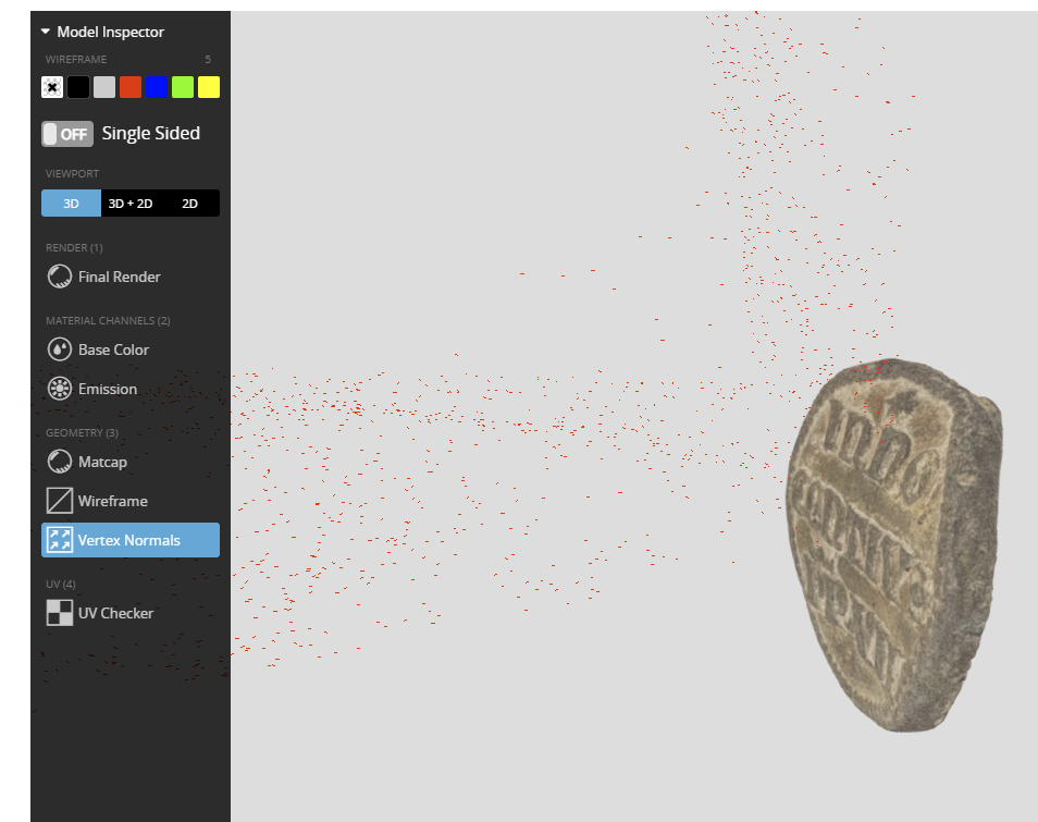

    Awesome great to hear KeesZ - Nice model! I jumped into the inspector in Sketchfab and noticed these strange vertex normal artifacts:
    Click image for larger version  Name:	Screenshot 2025-06-25 173219.png Views:	0 Size:	159.5 KB ID:	9975
    I've not seen anything like this before - Did the model go straight from Zephyr to Sketchfab? Or did it stop off in another program like Blender on the way?
